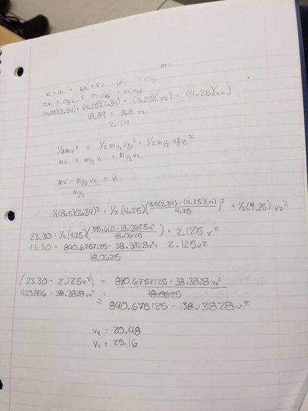

A(n) 8.5-kg object is sliding across the ice at 2.34 m/s in the positive x direction. An internal explosion occurs, splitting the object into two equal chunks and adding 12 J of kinetic energy to system. The explosive separation takes place over a 0.16-s time interval. Assume that the one of the chunks after explosion moves in the positive x direction. The x component of the average acceleration of this chunk during the explosion is afrontx, the x component fo the average acceleration of the other chunk during the explosion is arearx. What are the x components of the average accelerations of the two chunks during the explosion?
k=1/2mv^2
k=1/2(8.5)(2.34)^2
= 23.27J
23.27+12=35.27J
35.27/0.16= 220.4m/s^2
i've never done a problem like this
What values are required to compute the average acceleration? ( or what's the formula for it).

i got answers of 20.48 and 25.16. they're wrong
that was my work
Your application of momentum conservation doesn't look right.

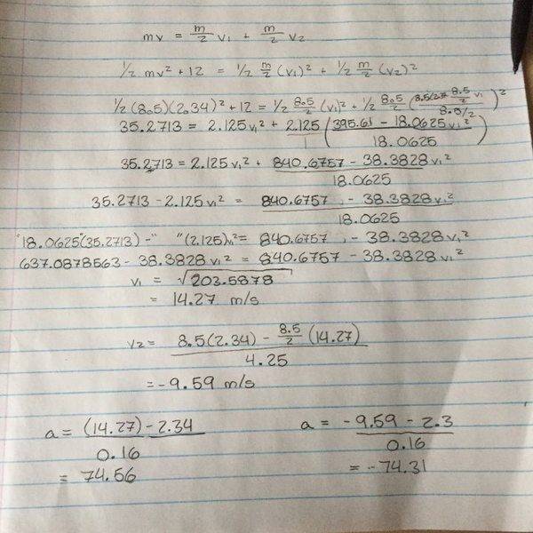

Suppose ##v## to be the initial velocity of the block and ##v_1## and ##v_2## be the final velocities of the two pieces. If the mass of the block is ##m##, the conservation principle gives $$p_i = p_f $$
$$ mv = \frac {m}{2}v_1 + \frac{m}{2}v_2 $$
This is your first equation. Similarly, for kinetic energy you'll get $$ \frac{1}{2}mv^2 + 12 = \frac{1}{2}\frac{m}{2}(v_1)^2 +\frac{1}{2}\frac{m}{2}(v_2)^2 $$
Solve these two equations for ##v_1##and ##v_2##. Use them in the formula for average acceleration.

i got answers of 74.56 and -74.31 for acceleration which are wrong
That doesn't match with my results either.
What values did you get for ##v_1## and ##v_2## ? Show your work.
i go values of 14.27 m/s and -9.59 m/s
In the third line, you have substituted for ##v_2## in terms of ##v_1##. You seem to have made a mistake there.

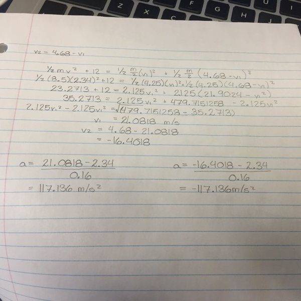

From the first equation(momentum conservation), we get ##2v = v_1 + v_2##. Or ##v_2 = 4.68 - v_1## . Use this in your second equation.
i got accelerations of -117.136 m/s^2 and 117.136m/s^2
is this correct?
emily081715 said:
is this correct?
I don't think so. You're one step closer though. The average accelerations you get must have the same magnitude and opposite signs. Show your work for the above result.
what did i miss?
emily081715 said:
what did i miss?
In the third line you've written ##(4.68-v_1)^2## as ##( 21.9014-v^2_1)##. Are you allowed to do that?
Wouldn't you apply the ^2 to both numbers?
Or would you have to turn it into 21.904-9.36v1 -v1^2
The expansion for ##(a-b)^2## is ##(a^2+b^2-2ab)##
That's what this is 21.904-9.36v1-v1^2
i got accelerations now of 7.1 and -7.1 m/s^2

That last term should be positive:
21.904 - 9.36v1 + v12
