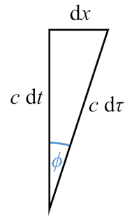

Sorry, Dale, but that is the definition of celerity, not rapidity.
$$\begin{align*}
\text{Velocity } \textbf{v} &= \frac{\text{d}\textbf{x}} {\text{d}t} \\
\text{Celerity } \textbf{w} &= \frac{\text{d}\textbf{x}} {\text{d}\tau} = \gamma \textbf{v} \\
\text{Lorentz factor } \gamma &= \frac{\text{d}t} {\text{d}\tau} \\
\text{Rapidity } \phi &= \tanh^{-1} \left( \frac{1}{c} \frac{\text{d}x} {\text{d}t} \right) = \sinh^{-1} \left( \frac{1}{c} \frac{\text{d}x} {\text{d}\tau} \right) = \ln k \\
c^2 \, \text{d}\tau^2 &= c^2 \, \text{d}t^2 - |\text{d}\textbf{x}|^2 \\
\text{Doppler factor } k &= \sqrt \frac{c + v} {c - v} = \text{e}^\phi \\
w/c &= \sinh \phi \\
\gamma &= \cosh \phi \\
v/c &= \tanh \phi \\
\end{align*}$$
Oops, sorry about the mistake and thanks for the correction!

So rapidity is the inverse cosh of the Lorentz factor? What does that mean physically, now?
EDIT- also now I'm curious about cerelity. Because it if's:
##\gamma \textbf{v} ## Well, that's almost like
##\gamma \textbf{u} ##
which if you multiply my mass you have relativistic momentum, and can go from there to get everything else.

  • #33
Sorcerer said:
then divide by proper time, written as ##\frac{dt}{\gamma\ }##
I think you mean ##\frac{dt}{d\tau}##. The 4-velocity vector's components are
U^\mu = \left( \frac{dt}{d\tau}, \frac{d \textbf{x}}{d\tau} \right) = \left( \gamma, \gamma \textbf{v} \right)
(in units where ##c = 1##). Multiplying by the invariant mass ##m## then gives the 4-momentum ##P^\mu##.
  • #34
Well, as I understand it, ##\frac{dt}{d\tau}## = γ, hence proper time must be ##\frac{dt}{γ}## . So dividing dx by that will give ##\frac{dx}{\frac{dt}{γ}}## which is ##γ\frac{dx}{dt}##, or ##γu## .But yeah the net result is exactly what you put there. I guess it is indeed a 4-velocity, except I'm ignoring y and z.
So why does that look the same as celerity? Is celerity exactly what the spatial components of 4-velocity are?
  • #35
Sorcerer said:
as I understand it, dtdτdtdτ\frac{dt}{d\tau} = γ, hence proper time must be ##\frac{dt}{γ}## .
If you want to treat differentials that way (which would give many rigorous mathematicians apoplexy, although most physicists wouldn't bat an eye), then yes, you can write ##d\tau = dt / \gamma##.
Sorcerer said:
So dividing dx by that will give ##\frac{dx}{\frac{dt}{γ}}## which is ##\gamma \frac{dx}{dt}##, or ##\gamma u## .
Yes, which is what @DrGreg was calling ##\gamma \textbf{v}##, as I said before (and that's how I wrote it in my post).
Because, as @DrGreg posted, celerity is equal to ##\gamma \textbf{v}##.
