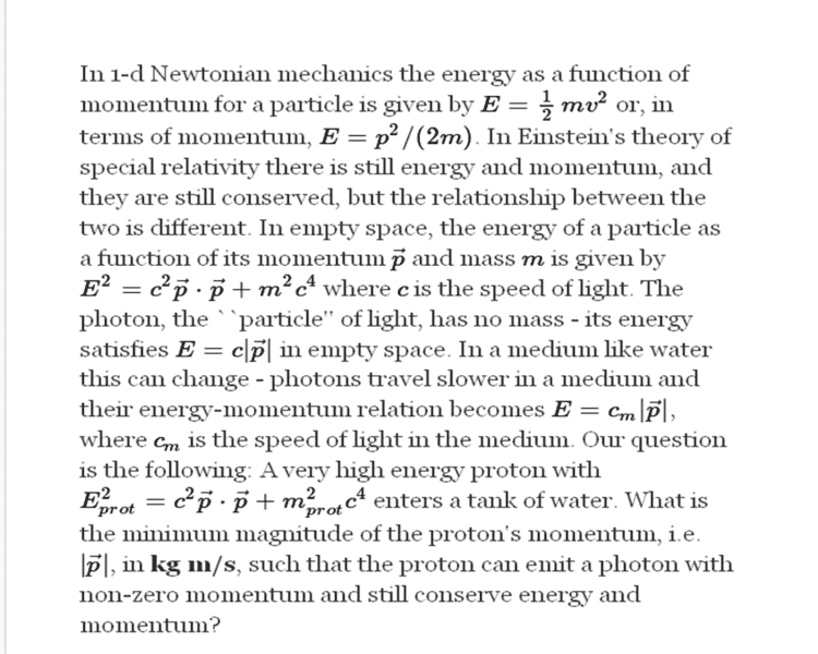

(see attachment)
Given data:
1.The speed of light in empty space is ##3 \times 10^8 m/s##.
2.The mass of the proton is ##1.67 \times 10^{-27} kg## .
3.The speed of light in water is ##2.3 \times 10^8 m/s##.
4.When photon emission begins to occur the initial proton, the final proton, and the emitted photon all travel in the same direction.
I don't have any knowledge about theory of relativity but I think this question can be done using the info given in the question.
Initial energy of proton, ##E_i=\sqrt{c^2p^2+m_0^2c^4}##
Final energy of proton, ##E_f=\sqrt{c^2p_1^2+m_0^2c^4}##
where ##m_0## is the rest mass of proton, ##p## is the initial momentum of proton and ##p_1## is the final momentum when it enters the water.
Using conservation of energy,
[tex]E_i=E_{photon}+E_f[/tex]
Using conservation of linear momentum,
[tex]p=p_1+p_2[/tex]
where ##p_2## is the momentum of emitted photon.
I can find ##p_2## in terms of ##p## and ##p_1## but I am not sure what I am supposed to do here. I can substitute p_2 in the energy equation but what am I supposed to do with that equation? :confused:
Any help is appreciated. Thanks!

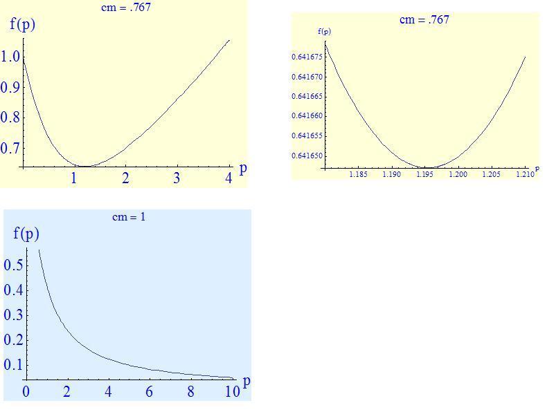

The expression ##\sqrt{c^2p^2+m_0^2c^4} - \sqrt{c^2p_1^2+m_0^2c^4} = c_m(p - p_1)## can be rearranged as ##\sqrt{c^2p^2+m_0^2c^4} - c_mp = \sqrt{c^2p_1^2+m_0^2c^4} -c_mp_1##
Measuring ##p## in units of ##m_0c## and measuring ##c_m## in units of ##c## we have
##\sqrt{p^2+1} - c_mp = \sqrt{p_1^2+1} - c_mp_1##
Thus, defining ##f(p) = \sqrt{p^2+1} - c_mp## we have ##f(p) = f(p_1)##.
A plot of ##f(p)## for water (##c_m = .767##) is attached. The intersection of a horizontal line with the graph would correspond to possible initial and final momenta of the proton, with the initial momentum being the larger momentum. The minimum of the function occurs where the initial proton momentum would have its minimum value and still be able to emit a “soft” photon. This is seen to occur near ##p = 1.195 ## (or, ##5.98 \times 10^{-19}## kgm/s). This, of course, agrees with haruspex’s calculation.
In a vacuum, we would have cm = 1. The attachment shows a plot of f(p) for this case and we can see the function no longer takes on a minimum. So, as expected, the proton cannot emit a photon and conserve energy-momentum in a vacuum.
In fact, it is easy to show that the value of p that minimizes f(p) corresponds to the proton having a speed of cm. So, only when the proton enters the water with a speed greater than the speed of light in water can the proton emit a photon.
So I guess this has has something to do with Cherenkov radiation. But I wish I understood better why simply using ##E_{photon} = c_mp_{photon}## for the photon in water automatically takes into account transfer of energy and momentum with the water. I had never seen this before.
