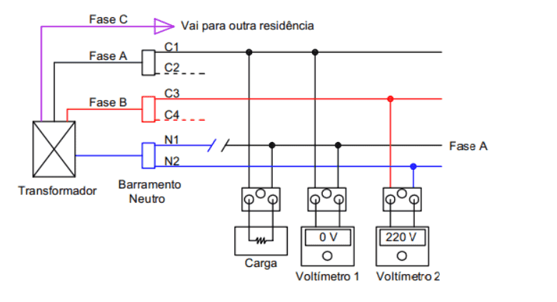

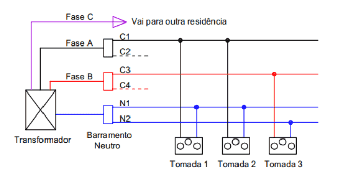

Ok, first I want to say that I am an electrical engineer. I want to be very clear that I am trying to understand a specific situation that I came across. I am searching for an answer of why and how this situation could happen. I don't want a solution for the problem, just a theoretical, physical explanation. The other thread I posted was locked due to an apparent "safety" issue. I can't stress this enough, I am not looking for tips about what to do or how to proceed. My issue is with the theory behind this. So we might as well treat it as an hypothetical situation.
This is an example circuit of a 2 phase house (220 V phase-neutral). Phase C of the transformer goes to another house, while phase A and B are the phases of this house.
C1,C2,C3 and C4 are the 4 circuits this house has each with its respective circuit breaker. N is the neutral bar that is shared among all circuits in N1 and N2. Tomada 1, 2 and 3 are the outlets 1, 2 and 3.
Now, the neutral opened right after the neutral bar in N1, affecting C1 and the two outlets that belong to this circuit. If you put a load in outlet 1, the potential of phase A will be transferred to N1 that is connected in the outlets. However, there will be no voltage because there is no potential diference and a multimeter in outlet 2 would register 0 V.Any device pluged in outlet 2 won't work. Outlet 3 will work normally.

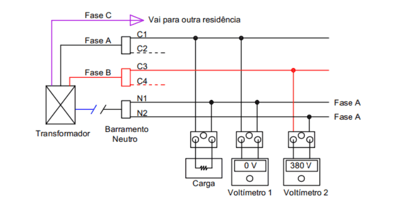

Now, consider this last scenario, where the opening happens before the neutral bar. Now the load in outlet 1 also transfers the potential of phase A to N1, there is no voltage in outlet 2 and there will be a higher voltage in outlet 3, since it's neutral now has the potential of phase A. Outlet 3 is now a phase-phase 380 V outlet.
Now, I would like to question:
1- If I say that the load plugged in outlet 1 in both scenarios is still working. What could possibly be allowing this to happen?
2- If there was a combination of the two scenarios, an opening before the neutral bar and an opening in both neutrals (N1 and N2), and the multimeter in outlet 2 registered 220 V. How could that be possible?
Somewhere in the house, N1 and N2 are connected, or have been confused so outlet 1 is in series with another load, between the two phases = 380 V.
Again, there is a connection between the neutral N1 and N2, or the wrong neutral has been used for some outlet load. A high impedance voltmeter is an unreliable detector of AC voltage, unless it is in parallel with a load.

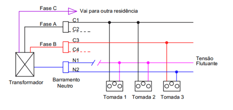

Baluncore said:
Somewhere in the house, N1 and N2 are connected, or have been confused so outlet 1 is in series with another load, between the two phases = 380 V.Again, there is a connection between the neutral N1 and N2, or the wrong neutral has been used for some outlet load. A high impedance voltmeter is an unreliable detector of AC voltage, unless it is in parallel with a load.
That's what I thought. However, imagine now that the house has 7 different circuits (7 circuit breakers) and this situation still happens. This means all 7 neutrals are connected? I believe this is impossible, since the circuits paths are not all of them interconnected in the house, except for the neutral bar. Unless there is a connection of all of them right after the bar, where all the 7 neutrals go down the conduit.
In the case of a connection between N1 and N2 or a wrong neutral, wouldn't there be a higher voltage there? Even with no opening in the neutral?
No. The neutrals are all at the same potential.

ffp said:
I know, but now you have 2 different phases in the circuit, since neutral of phase A and phase B are connected. There can't be 220V, right?
But that is the normal situation. All the neutrals are connected together at the neutral bar.

ffp said:
How could an outlet register 220 V?
The series connection of two loads on two phases can generate about 220V.
It all depends on the load impedance and how you measure the voltage.

What if there is no load in that circuit except for maybe some light bulbs?
Also, the multimeter would have to enclose both (or more) devices to see the full voltage reduction. If it is just put on the phase and neutral terminal of an outlet of this circuit that only has loght bulbs, it would show 380V, am i right?
I don't get how a circuit with 3 outlets and a couple light bulbs would not show 380V in that case...
To help sort it out, try disconnecting (at the breakers?) various loads individually and in combination.
With good documentation of measured voltages and many sketches, the answer may well pop out.
Light bulbs are a real load.
If a wire is open circuit, you may be reading the capacitive coupling between the wires. The problem is when you measure a voltage with a modern multimeter you are drawing insufficient current to get a true voltage reading. You need to momentarily connect a load such as a filament bulb in parallel with the meter to identify how reliable the voltage reading really is.
Likes PeterDonis and Tom.G
