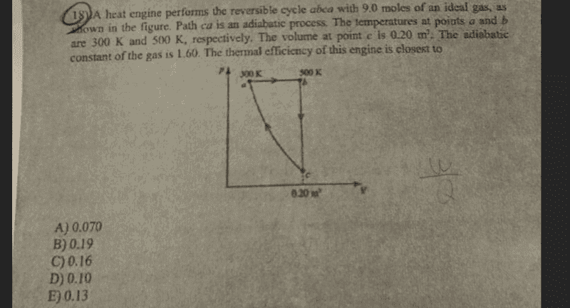

http://i.imgur.com/SQ6jx94.png
(sorry for the low resolution~ it's already the best i can make it~)
U=Q+W
the three variables of isobaric, isochoric, adiabatic process (can i save my effort from typing all of them out?)
e=(Qh-Qc)/Qh
Substitute the relevant equations in order to get Qc & Qh
it always seems a lack of information to the three points
there should be a specific route for substituting the variables to the cycle and the few thought by me should be wrong
can anyone tell me the right way to get option "e" here?
Thank you
I haven't attempted a solution but usually these come from the data provided on the graph combined with your knowledge about what is constant during an isobaric, isochoric, or adiabatic process.
isobaric=>p constant
isochoric=>v constant
adiabatic=>q constant
So of P, V, and T which are you missing at each of the three points and how might you work them out from the info provided?
You must attempt the question yourself. Get as far as you can and then post that attempt here so that the homework helpers can see where your misunderstanding comes in.
