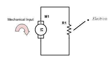

Dear sophiecentaur,
This is the conceptual situation I'm describing, the electron(s) have already left the circuit, what happens with the current in the wire? As to the number of electrons leaving; then it would be the maximum number that is physically possible by any means.
I'm not proposing anything, I'm asking out of doubt. I mentioned "static electron starvation" as my suggestion, if this is wrong then I would obviously appreciate to be corrected.

That symbolic representation is just the sort of thing we all need, even though it may seem 'obvious' to you - thanks.

It's purely a matter of the actual quantities involved. Removing a single electron would in principle make a difference to the resistance in the circuit. However, there will be something in the order of at least 1020 electrons available in a typical piece of metal equipment. To remove just 1% of available electrons would require far more energy than would be provided by the thermionic effect - in fact the thermionic effect only applies to the surface atoms. The lower atoms would only lose electrons if the metal were hot enough to be so the model would not apply.
Something I only just thought of is that the temperature of the metal would have more effect on its resistivity than any tiny number of 'lost' thermionic electrons could account for. As I pointed out before, the NUMBERS count in all Science. I cannot see any way that the thermionic effect on resistivity could be measured; it's many orders of magnitude less than other effects.
I notice that you mention 'other' methods of removing electrons. It is possible to discharge electrons from an insulated circuit but the static voltages involved would have to be of lunatic proportions in order to distort the Electric Fields within the circuit enough to alter its function.

Dear sophiecentaur,

So if I understand correctly you are saying that the situation I'm describing would not occur under normal operating conditions, yes I can concur.

Purely theoretical then, if tension of lunatic proportions were present, in what way would it alter the circuits function?
1. Massive static fields needed to remove sufficient electrons would not be practical even if possible in principle.
2. Heating current passed through a thermionic electrode in a thermionic valve would cause a Voltage drop. The current through the diode(say) would also cause Voltage drop across the filament. But this is not a static situation. You may need to read around about thermionic valves if you aren’t familiar with them. Google is your friend.
