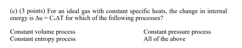

TL;DR Summary: why is the answer "all of the above"?
Could someone explain why the correct answer is all of the above? I understand that Cv implies a constant volume process, but what about the other two?
Because internal energy of an ideal gas depends only on its temperature.

The fact that you can write the internal energy of an ideal gas as ##U = C_{_V} T## doesn't mean that this formula can only be used in constant-volume processes. Internal energy is a state variable and for an ideal gas ##U## is proportional to the absolute temperature. In the formula ##U = C_{_V} T##, think of ##C_{_V}## as just a number (with units) that gives the proportionality constant between ##U## and ##T##.
Note that in the formula ##U = C_{_V} T##, ##C_{_V}## is not the specific heat capacity. It's the total heat capacity which takes into account the amount of gas. Often, you see the formula written as ##U = nC_{_V} T## where ##n## is the number of moles and ##C_{_V}## now represents the molar specific heat capacity.
