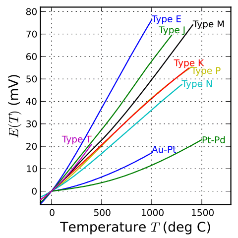

Can I use a thermocouple which has a temperature difference of 1 degree to generate current to run a very small led.
If you find some way to have a huge heat flow and if you can increase the voltage by orders of magnitude: maybe. In practice, probably not. LEDs need a minimal voltage (depending on the color, but at least ~2V) to work.
Here's a graph showing the Millivolts produced at various temperatures for several common Thermocouple types. Not much change in voltage per ºC change in temperature.

Yes, LOL, you'll need a zillion thermocouples to make it from 1 degree C or F.
