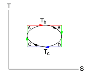

n moles of gas, that follow van der Waals equation are to be employed as the auxiliary system in a circular cycle(parameterized using T_h and T_c as shown on the TS diagram. Calculate the efficiency of the cycle.

Idea is simple. I just divide circle curve horizontally in two two curves. Using Q = TdS , by integration over the top curve i obtain Q_(in), by integrating over the bottom curve i obtain Q_(out). Then i easily get efficiency using equation above. The only problem is, that i don't know, how to calculate those integrals with only van der Waals equation of state initially given.

What is the equation for the area of an ellipse in terms of the semi major and semi minor axes?
Sorry, I wasn't precise enough, it has to be a circle, not an ellipse. I put that diagram more for an illustrative purpose.
How can it be a circle if the units are different? If you change the units of either T or S, the shape changes.
Absolutely.
The task itself states, that we are given a cycle, which is represented as a circle on a T-S diagram, which is parameterized using T_h and T_c.
My main concern though is, how would i get an expression of T as a function of S...

$$\left(\frac{T-\frac{(T_H+T_C)}{2}}{\frac{(T_H-T_C)}{2}}\right)^2+\left(\frac{S-\frac{(S_{max}+S_{min})}{2}}{\frac{(S_{max}-S_{min})}{2}}\right)^2=1$$
Like I said, since T and S have different units, you can't represent the variation as a circle on a T-S diagram. What don't you understand about this?
I do understand it now. Thank you :)
So what do you get for the efficiency?
