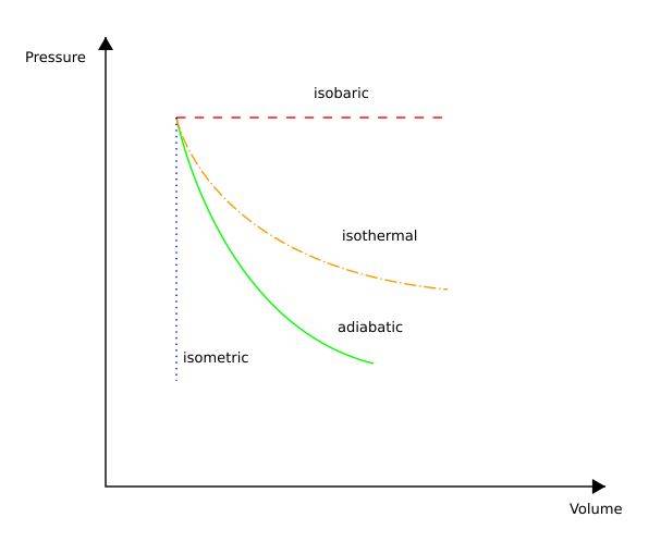

Do you think my lecturer is correct in saying this is the correct answer? Question: For a given starting pressure and volume, which of the following compression processes requires the most work to reach a final volume: Isothermal, isobaric, adiabatic, isochoric?
delta(U) = Q - W
Likes Delta2
You have just posted the model answer. In the homework sections you are required to provide your own arguments and reasoning. So you seem to disagree with the model answer, why?
The reason I chose isobaric is because of the diagrams that I have seen in textbooks and other sources where it appears that the area under the curve is greater than other processes.
The question is about compression, you might want to draw that diagram again, where all the processes start out at the same volume and pressure, and the volume decreases, while the pressure increases.
Likes Lnewqban, BvU, Delta2 and 1 other person
To build a bit upon that. In the diagram you have attached, if you consider the curves curves for compressions (i.e., going right to left along the curves), then they all end at the same volume and pressure. However, the problem statement tells you that the processes should all start at the same volume and pressure, which makes the analysis different.
It is however questionable that the problem statement calls an isochoric process a compression process since volume is constant in such a process by definition.
Likes Lnewqban
Thank you for your input I am now able to see that adiabatic is the correct answer.
Thank you for your reply I am now able to understand the reasoning behind the correct answer.

kuruman said:
The isobaric process has more area under the curve
No it does not. Not if drawn in accordance with the problem statement that specifies equal pressure and volume before compression, ie, the curves should coincide on the right side. The isobaric curve will lie below all the others.
Likes Delta2
Yes, of course. I should have drawn an actual diagram instead of doing it in my head. Anyway, I had my rant for the day.
