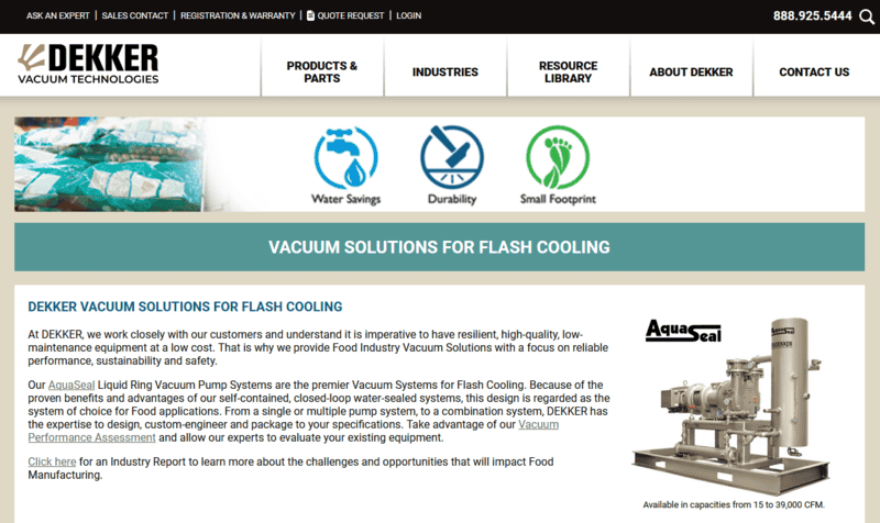

Do you mean in a vacuum flash cooling system like this one?
https://www.dekkervacuum.com/flash-cooling/
Yes, though its i think somewhat bigger, it features a vacuum pump and a condenser to maintain a low pressure, Basic goal is oe eliminate dissolved oxygen and air bubbles, i need to figure out how much volume is lost
