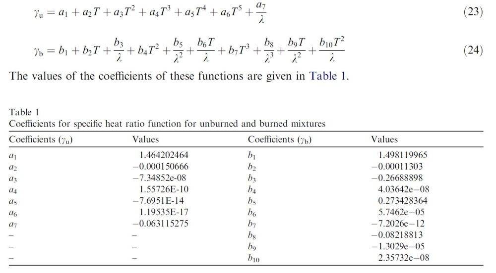

The critical specific heat ratio (y) varies with temperature and mixture composition. The paper "https://www.researchgate.net/publication/222535464_Temperature_and_air-fuel_ratio_dependent_specific_heat_ratio_functions_for_lean_burned_and_unburned_mixture" provides a pretty good summary of the variance in y depending on temperature and mixture composition. Below is a snapshot of the key section giving the equation for y when the mixture is unburned (yu) and burned (yb) where T is temperature (K) and λ is the air-fuel ratio. Note the equaton for pure air is available on-line.
244262
Given all the above, you can create an Excel spreadsheet that starts with atmospheric conditions in the intake volume from which you can calculate mass via PV=mRT where P is in Pa, V is in m3, m (mass) is in kg, R is 286.98 and T is in K. Next, make a table of V values between initial and compression V noting that compression V/initial V is the compression ratio. If you wish, the compression V can also be calculated from a target pressure or temperature with good reason (more later).

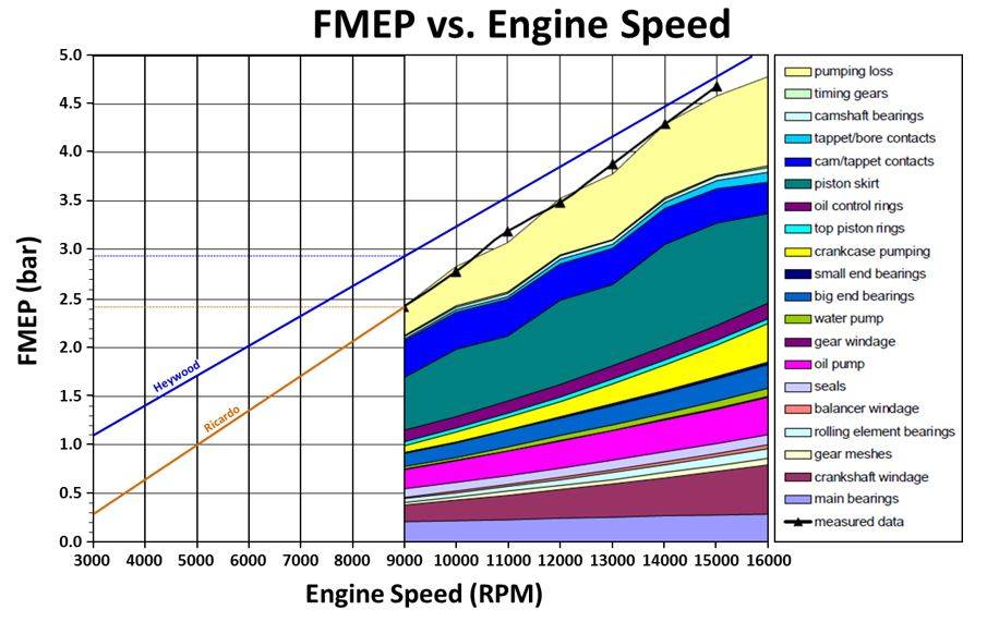

Now about accuracy...
A key error source not described is friction. It can be estimated using the figure below that I compiled from two key sources, Ricardo and Heywood. The figures are for a 6 cylinder engine. To use this data, you'll have to calculate HP the way professionals do using IMEP, FMEP, and BMEP: IMEP (bar) = Work (J)/Displacement (m3), FMEP (bar) from the figure below, and BMEP (bar) = IMEP-BMEP. Once you have BMEP, the calculations at http://www.epi-eng.com/piston_engine_technology/bmep_performance_yardstick.htm and a few unit conversions can be used to calculate HP and Torque (lb-ft).
244269
