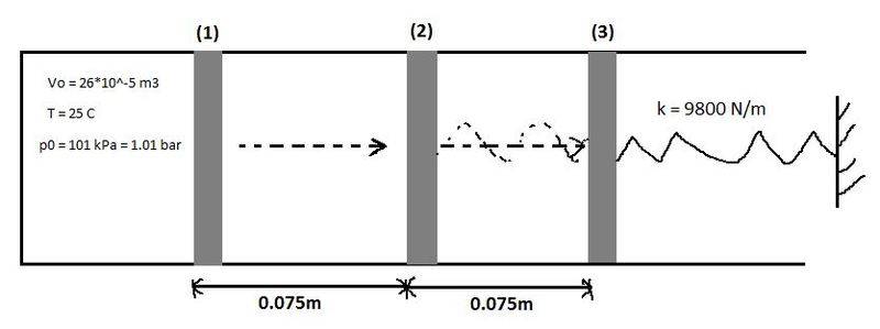

W = ∫pdV
W = (1/2)*k*(x2212)
F = p*A
Assumptions made:
1. Quasistatic process.
2. Pressure is constant.
Force balance on the piston reveals
p0*Apiston = patm*Apiston hence p0 = patm = 101 kPa
From states 1-2 this is a constant pressure process:
W12 = p0*Apiston*d1 = (101 kPa)(44*10-4 m2)(0.075m) = 33.333 Joules
From states 2-3 this is both a constant pressure process and a spring compression process (taken separately):
W23 (const) = p0*Apiston*d2 = (101 kPa)(44*10-4 m2)(0.075m) = 33.333 Joules
W23 (spring) = (1/2)*k*(x2212) = (1/2)*(9800 N/m)(0.075m)2 = 27.562 Joules
Total work done from the initial to the final state is equal to the summation of the three works done above:
Wtotal = W12 + W23(const) + W23 (spring)
Wtotal = 33.333 + 33.333 + 27.562 = 94.228 Joules of work done.
Is my approach to this question reasonable? If not what can I do to fix or look up where I've gone wrong?
As always, every ones help is greatly appreciated.
