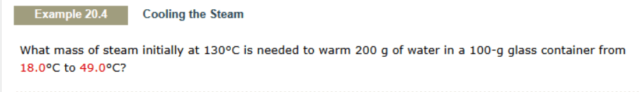

What mass of steam initially at 130°C is needed to warm 200 g of water in a 100-g glass container from 27.0°C to 42.0°C? If we instead used 78.0 g of water, how much 100°C steam remains in thermal equilibrium?
