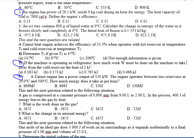

I need help with question 2,5,6,7,9,10. I have posted a word file with all the questions below.

Q2:
An engine has power of 26.5 kW, needs 9 kg coal during an hour for energy. The heat capacity of coal is 7800 cal/g. Define the engine’s efficiency.
Qh= mcΔT = 9000x7800xΔT ( stuck)
P=26.5kW(is this the power output of the engine in an hour?)
If only I could find ΔT, thenI would be able to calculate Efficiency e=W/Qh; I might get W from the given P, but still the time interval on which the engine operates is not given...

Q6:
e(carnot)= 1 - Tc/Th=24/25
P =150kW, again I'm not sure on which time interval does the engine has this power but let's just assume it's a second then ==> P(hour)=125/3
e=24/25=P/W ( I think) ==> then W would be 43.4 J ?

Okay, let's tackle #6.
A Carnot engine has a power output of 150kW . The engine operates between two reservoirs at 150°C and 20°C . How much energy does it take in per hour ?
Do you understand what the problem is about ? and the elements it contains ?
What steps do you think should be accomplished to solve ?
How far have you gotten, so far ?
well for #6, I don't think I completely understand the problem as in I can't imagine a specific engine that matches the description, is this like a refrigerator, a heat pump or a heat engine? They stated that there is a power output which I believe to be the work done by the system when there's heat transfer from the hot to cold reservoir. But I don't remember any heat engine that takes in work or energy; heat pumps or refrigerator would take in work though.
Confused as I am, the only step I could take is to calculate the Carnot efficiency given the two temperatures.

Yeah thanks I just got 869 Mega Joules but it was a wild guess, I thought of the efficiency as the amount of useful power out of the input power and through a few calculations got the result I wanted. The thing is I used this method before and failed and I only succeeded this time cause I assumed the given power to be 150 KWh, is this right?

Question #2 is complete nonsense. It must read:
"An engine has power of 26.5 kW, needs 9 kg coal during an hour for energy. The heating value of coal is 7800 cal/g. Define the engine’s efficiency. "
The heating value of a substance is the amount of heat released during the combustion of a specified amount of it. https://en.wikipedia.org/wiki/Heat_of_combustion

THANK YOU. I am convinced that you are right, I checked the data on Wikipedia and converted coal's "heating value" to 7763 cal/g which of course would be rounded up to 7800. I wasn't clear on this before, all the wrong terminology lead me to the wrong calculations, man I was even wondering how to get delta(T) to find Q.
Anyway since the heating value is Q itself, I did a few unit conversion and found out the efficiency to be 0.32.
