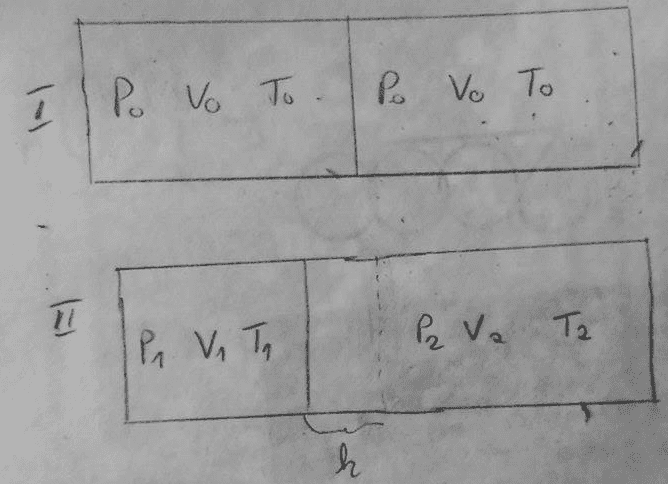

A horizontal cylinder with length L=1m and section S=2*10^(-3) is divided in two parts by a piston. In theese compartments is air at pressure p0=10^5N/m^2 and same temperature.
The piston move with h=0,4m from initial position. Which is force to hold piston in this position ?

I'll give some hints. The first step is going to be finding the new pressures on both sides in the piston after you move the piston. For that, you'll be using P0V0=P1V1.
After you know the pressure on both sides, you need to find the net force on the dividing wall between the two sides. If you know the pressure, and you know the area, how do you find the force exerted by either side? Look at the units for pressure and area.

It follows from the ideal gas law, assuming that the temperature and number of moles don't change.$$nRT_0=P_0V_0=P_1V_1$$

I've found P1 & P2:
P1= P0L/L-2h
P2=P0L/L+2h
Now, i must to found the force.
F=P*S but what P i must multiply to S to found force ?
I solve it ! F=(p2-p1)*S = 888N

Apparently they expect you to assume that the cylinder and piston are not insulated. So, when the system equilibrates, the temperature will be unchanged.

It could also be done if the two chambers and the piston were adiabatic, and the piston were moved very slowly.
