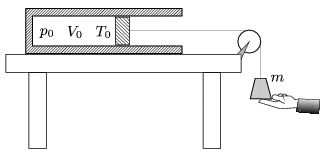

An easily moveable, thermally insulated piston of negligible mass confines a sample of air of volume ##V_0=8\,\, \text{litre}##, at a temperature of ##T_0=300 K##, into a thermally insulated cylinder of cross section ##A=1\,\,dm^2##. The cylinder is fixed to a horizontal table. The pressure of the confined air is the same as the atmospheric pressure ##p_0=105 \,\,Pa##. A piece of thread is attached to the centre of the piston, it lies in the line of the axis of the cylinder and leads through a pulley. A weight of mass ##m=25\,\, kg## is attached to the other end of the thread as shown in the figure. Holding the weight, any part of the thread is straight, but loose.
The weight is released without any push. To an accuracy of 1% determine the
a) temperature of the air in the cylinder, when the weight is at its lowermost position;
b) the acceleration of the piston at the lowermost position of the weight;
c) the greatest speed of the piston during the process. (The mass of the thread and the pulley and friction are negligible.)
I am thinking of using conservation of energy but I am not sure which expansion process should I consider. If I consider adiabatic, I need the adiabatic constant which is not mentioned in the problem statement. I can't think of any other process which takes place in a thermally insulated cylinder. :confused:
Any help is appreciated. Thanks!

Okay, I took it as diatomic so ##\gamma=7/5## (adiabatic constant). At the lowermost position of block, the kinetic energy of block is zero, so from conservation of energy:
$$mgx+p_{atm}Ax=\frac{p_0V_0-P'(V_0+Ax)}{\gamma-1}$$
and
$$P'=\frac{p_0V_0^{\gamma}}{(V_0+Ax)^{\gamma}}$$
where ##p_{atm}## is the pressure due to air outside and x is the displacement of block. Solving the above gives me a negative value for ##x##. :(

I set x=0 and t=0 when the string tightens. Let the displacement of block when it is at lowermost position be ##x##. Since there is no change in kinetic energy, the sum of work done by gravity on block, work done in expansion by confined and the work done by the air outside on the piston is zero i.e
$$-mgx+\frac{p_0V_0-P'(V_0+Ax)}{\gamma-1}-p_{atm}x=0$$
which is the same equation I wrote above, please let me know if anything is still unclear.

This is what I have:
$$mgx+\frac{p_0V_0-P'(V_0+Ax)}{\gamma-1}-p_{atm}x=0$$
where
I simplify the middle term in the energy equation:
$$\begin{align*}
\frac{p_0V_0-P'(V_0+Ax)}{\gamma-1} & = \frac{1}{\gamma-1}\left(p_0V_0-\frac{p_0V_0^{\gamma}}{(V_0+Ax)^{\gamma}}(V_0+Ax)\right)\\ & = \frac{p_0V_0}{\gamma-1}\left(1-\left(1+\frac{Ax}{V_0}\right)^{1-\gamma}\right)\\
\end{align*}$$
So the energy equation becomes:
$$mgx+\frac{p_0V_0}{\gamma-1}\left(1-\left(1+\frac{Ax}{V_0}\right)^{1-\gamma}\right)=p_{atm}Ax$$
Plugging this in Wolfram Alpha doesn't give me the answer. :(
http://www.wolframalpha.com/input/?i=25*9.8*x+(105*8)/(2/5)*(1-(1+10^(-2)x/8)^(-2/5))=10^5*10^(-2)*x
I take ##P_{atm}\approx 10^5 \,\,Pa##.

This is basically going to be analogous to a SHM problem, except that the spring (in this case, the gas in the cylinder) is nonlinear. If T is the tension in the string, then a force balance on the piston gives:
T = (P0-P)A, where P is the pressure in the cylinder, and P0=Patm=105 Pa.
A force balance on the mass gives:
[tex]mg-T=m\frac{d^2x}{dt^2}[/tex]
The gas is expanded and compressed adiabatically, so
PVγ=P0V0γ
or, equivalently,
[tex]P=P_0\left(\frac{V_0}{V_0+Ax}\right)^γ[/tex]
Combining the previous equations gives:
[tex]m\frac{d^2x}{dt^2}=mg-AP_0(1-\left(\frac{V_0}{V_0+Ax}\right)^γ)[/tex]
If we multiply this equation by v = dx/dt and integrate from 0 to x, we obtain:
[tex]m\frac{v^2}{2}=mgx-AP_0x+\frac{P_0V_0}{γ-1}\left(1-\left(\frac{V_0}{V_0+Ax}\right)^{γ-1}\right)[/tex]
This confirms Panov-Arora's result for the case in which v = 0. This corresponds to the lowest point reached by the mass. The point of maximum velocity is where the acceleration= 0 (this is also the equilibrium point). This is where:
[tex]AP_0(1-\left(\frac{V_0}{V_0+Ax}\right)^γ)=mg[/tex]
Chet

For the b) part, I solved the problem using Newton laws. And the equation I used is similar to the Chestermiller.
For the c) part, I used energy conservation. But first, I found ##x## from the Newton's second law. The velocity is maximum at the equilibrium point. From Newton's second law:
$$m\frac{d^2x}{dt^2}=mg-Ap_0\left(1-\left(1+\frac{Ax}{V_0}\right)^{-\gamma}\right)=0$$
Solving for ##x## gives ##x=0.177847\,\,m##.
From energy conservation,
$$mgx+\frac{p_0V_0}{\gamma-1}\left(1-\left(1+\frac{Ax}{V_0}\right)^{1-\gamma}\right)-p_{atm}Ax=\frac{1}{2}mv^2$$
But solving for ##v## doesn't give me the right answer. :confused:
http://www.wolframalpha.com/input/?...2/5))-10^5*10^(-2)*x=1/2+*+25*y^2,+x=0.177847
The given answer is ##0.4\,\,m/s## but I get ##1.2\,\, m/s##. :(

I didn't say it was SHM. I said it was analogous to SHM. As Voko implied, if you linearize about the equilibrium location x = 0.178 m, you get the differential equation for SHM. From this, you can actually determine the spring constant k for the cylinder/piston "spring." I recommend that you try it and see.
I confirmed your value for the equilibrium length, and, when I substituted this into your equation for the velocity, I got 1.27 m/s.
Incidentally, I assume there was a mistake with regard to the mass m in the problem statement. Apparently, m = 25 gm, not 25 kg.
Chet
Chestermiller said:
Oops. You're right. I made compensating errors with units to get the correct equilibrium location. I'll redo my calculations for the velocity.
Chet
I have used the same values given in the problem, what is wrong with my calculations? :confused:
  • #31
As I said in my previous edited posting, I redid my calculations, and obtained 0.178 m for the equilibrium position and 1.27 m/s for the velocity. This velocity agrees with your value.
Chet
Likes 1 person
  • #32
Chet
Ah, then the given answer must be wrong.
Thanks for the help voko, Chestermiller and DrClaude! :smile:
