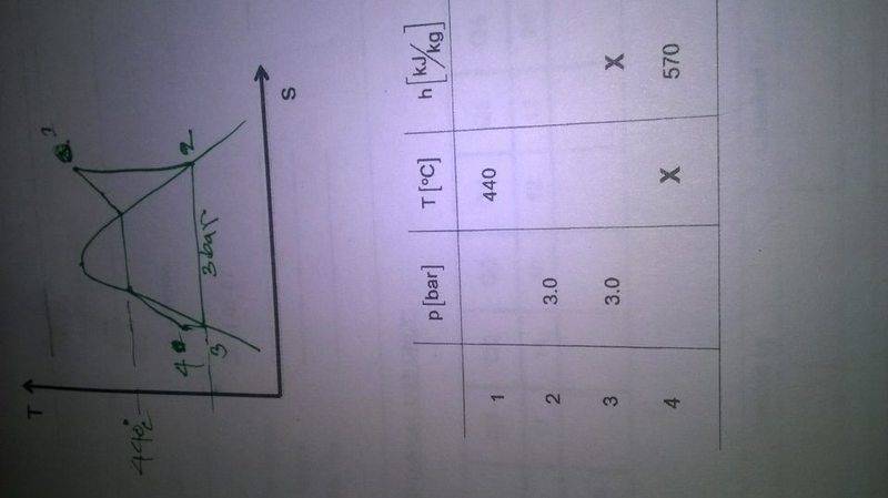

1. Steam is the working in an ideal rankine cycle with super heating . Super heated vapor (state 1)
enters the turbine at a temperature of 440 °C. Saturated vapor(state 2) exits the turbine at a pressure of 3.0 bar.
2. a) Sketch T-S diagram.
b)Determine the thermal efficiency of the ideal rankine cycle.
Assumption:
1...Turbine in
2... Turbine out
3... Condenser out
4... Boiler in
[/B]
my question is that how I can find out the pressure of the cycle at state 1?
What is the relationship between state 1 and state 2 in terms of entropy? Does your steam tables have data for superheated steam? What is the entropy of the steam in state 2?
