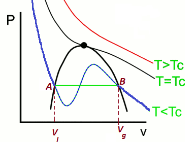

OK, scratch everything I said regarding question (6). I had to dig into one of my texts. You were correct in proposing setting the Gibbs potentials (chemical potentials) for the liquid and gas equal to one another (at liquid-vapor equillibrium). Sorry to have mentioned the Clapeyron equation - forget it.
Consider an isotherm of the Van der Waal's equation for a temperature below the critical temperature, such as the blue isotherm in the picture. Equality of the Gibbs potentials at points A and B can be used to find a relation between the pressure P (at A and B), the molar volume of the liquid ##v_l## at point A, and the molar volume of the gas ##v_g## at point B. Details are probably shown in most texts.
You can also use your equation of state at point A to relate P to ##v_l## and again at point B to relate P to ##v_g##.
Thus, you have three equations for the unknowns P, ##v_l##, and ##v_g##. Temperature T is presumed to be given. Looks like it would be hard to actually solve the equations.

OK, this looks good! But you can simplify it by using log(ab) = log(a) + log(b) to eliminate C and the 5RT/2 terms. Your result is equivalent to what I get if I follow a somewhat different way of expressing equality of the Gibbs potential in the two phases as given in my text. I like your way.
You also have the equality ##P_l = P_g##. Using the equation of state (i.e., your expression for P(V,T)), you get another equation relating ##v_l## and ##v_g##. So, in principle you could solve separately for ##v_l## and ##v_g## in terms of T.
Yes I made a typo when writing in latex here for the F function.
I see. I didn't realize that the pressures were equal in the coexistence liquid-gas. So this makes up for the 2nd equation.
I've simplified the argument in the logarithm for the expression of the equated potentials.
The 2 equations I must solve are then: 2a \left ( \frac{1}{v_l} -\frac{1}{v_g} \right ) +RT \ln \left ( \frac{v_l-b}{v_g-b} \right ) +RT \left ( \frac{v_l}{v_l-b} - \frac{v_g}{v_g-b} \right ) =0 (equated potentials)
and RT \left [ \frac{1}{v_l-b}-\frac{1}{v_g-b} \right ] +a \left ( \frac{1}{v_g^2} - \frac{1}{v_l^2} \right )=0 (equated pressures)
That is, if I made no mistake. I guess that's why they said to give a way to find ##v_l## and ##v_g## but not actually solve the equations explicitly.
So problem solved! Thank you very much for your assistance.
