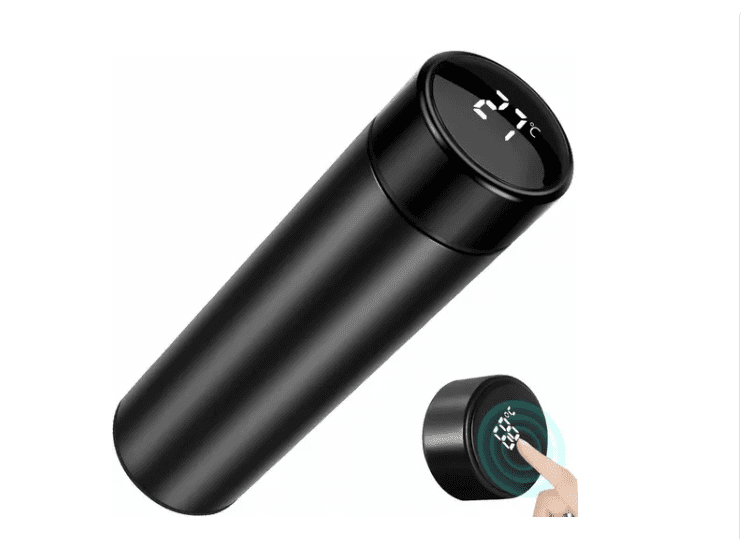

A thermology question: Keeping different cold and heat in thermos bottle
Manufacturer information:
Interior material: stainless steel
Exterior materials: Stainless steel
Keeps cold liquid for: 24 hours
Keeps hot liquid for: 12 hI was looking for a thermos bottle and came across a situation that I'm having a hard time answering.
Why is the cold keeping time different from the warm time?
barnabe_fisico said:
Summary: A thermology question: Keeping different cold and heat in thermos bottle
Probably because heat loss is proportional to the difference between inside and outside temperatures.
If your room is at 70F, cold water at 40F is 30F colder than the room, but boiling water at 210F is 140F hotter than the room.
