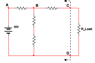

Determine the Thevein and Norton equivalents for this circuit where all resistors are 1k ohm's except the load. Ignore the load.
Ohm's Law
##V = IR##
##I = \frac{V}{R}##
The following picture is my attempt at the solution.
I think this is right but I'm not 100% sure.
It is correct! Nice work!
Likes cavalieregi
