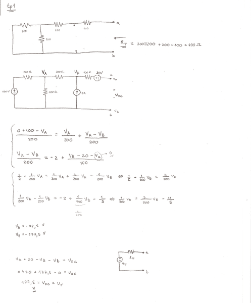

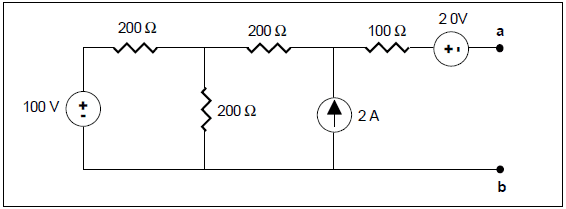

Consider this circuit. Find the Thévenin and Norton Equivalent Circuits (just need the 1st one).
My attempt:
Can someone check? Thanks a lot!
The Thevenin-equivalent resistance is correct.
You need to find the open-circuit voltage between a an b. If it is open no current flows through the 100 ohm resistor, so all the 2A current of the current generator flows to B and then to A, through the 200 ohm resistor. So you know at VB-VA.
ehild
So, there's an incorrect equation, right?
Yes, the second one.
ehild
Is it just (VB-VA)/200=2?
Yes.
ehild
Thanks a lot!
