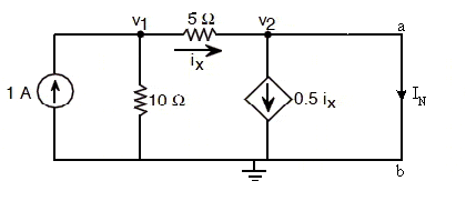

In summary: Whoops! I just realized that the controlled current source is still in the circuit even though the output is shorted! The path for the short circuit current is separate... so it'll look like:(V1/10)+(V1/5)=1V1=3.33So, Isc = V1/5ohms = 0.67 Amps (Because the current wouldn't flow through the branches with current dependent current source and 20ohms resistor)
Tekneek
70
For this problem (pic attached) I did the open circuit calculations and found V1 (6v) and V2 (4v) and I know they are correct. However I am not sure if my Voc and Isc (open circuit voltage and short circuit current) calculations are correct.
I am assuming V2 is Voc since they are in parallel? Also after creating a short circuit to find Isc, I used KCL at Node 1:
(V1/10)+(V1/5)=1
V1=3.33
Thanks for any help. Long time reader first time poster :)

Hi Tekneek, Welcome to Physics Forums.
Your calculations look fine. For the short circuit current calculation you could also have used the current divider formula, since the 1A divides between the 10 Ω and 5 Ω resistors.
The controlled current source is going to "steal" half the current before it gets to where the short circuit is. Very sorry about that.
