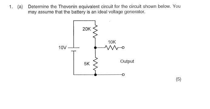

Given the circuit (Attached in image) Find the thevenin equivalent circuit.
I know its a fairly simple thing, But I am not understanding where the lecturer is getting this answer from, unfortunately his solutions just state the voltage so I feel like I must be missing something important.
Vth= (R1/Rtotal)xVtotal
I tried finding the voltage dropped over the 10Ω + 5Ω resistors, which I found to be 4.3v
Vth= (R1/Rtotal)xVtotal = 4.3v
Where R1 = 10Ω+5Ω
Rtotal=35Ω
But the lecturers solutions simply say Vth=2v
Any help is appreciated

What's the voltage across the output if there's no load? I.e., there is no current drop across the 10 kΩ resistor. You have a simple voltage divider with 20kΩ and 5kΩ .
