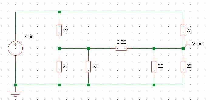

Find the Thévenin equivalent of the circuit and the required value of the load for maximum power transfer for [itex] Z = 15 + j24 Ω [/itex].
Voltage divider equation and [itex] Z_{in} = Z_{load} [/itex] 'complex conjugate' for maximum power transfer.
Thévenin equivalent:
Since there is no current flowing through 2.5Z:
[itex] V_{out} = V_{in} \times \frac{2 \parallel 5}{2 + (2 \parallel 5)} = 0.4167 V_{in} [/itex]
[itex] Z_{total} = 0.67Z [/itex]
Maximum power transfer:
[itex] Z_{load} = 0.67 \times (15-j24) = 10 - j16 Ω[/itex]
Does this appear to be correct?
Thank you for anyone looking into that.

Looks good!
Likes 1 person
Thank you!
