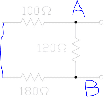

Thevenin equivalent resistance problem

I found that the current around the circuit was 5mA using kirchhoffs law ( i think)
If this is true then the T.E.V should be the voltage across the 120ohm resistor which is .6V (120*5e-3). Now I'm stuck and not sure how to find the T.E.R, thankyou

Hello glover261. Welcome to PF !
So far, so good.
What have you been taught regarding how to find the Thevenin equivalent resistance ?

Hi thanks, I thought you were supposed to take out all components except resistors in the circuit, current sources by open circuit and voltage sources through short circuit. Then just add up the total resistance of all the resistors, but that method does not seem to work on this problem, as none of the answers are the total resistance.
That's not quite right. You don't simply add all the resistances. You find the equivalent resistance across the terminals.

Aren't they all in series though? or am i missing something
You must be missing something.

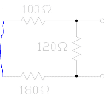

Draw what you have when the voltage source is shorted.

Sorry I still can't see it

See the terminals?

So, the 180 and 100 resistors are in parallel. So Rt = 1/((1/180)+(1/100)) + 120 = 184 ohms? Is that right because I thought for a pair of components to be in parallel, both sides had to be connected to the same node.
glover261 said:
So, the 180 and 100 resistors are in parallel. No.
I thought for a pair of components to be in parallel, both sides had to be connected to the same node. This is correct.

What do they mean?
glover261 said:
What do they mean?
Find the equivalent resistance across the terminals.
Look at the nodes again.
