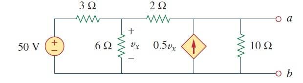

The problem ask for Thevenin Equivalent for the circuit attached.
Vth = Vab
Rth = Req
Rth = Vth / Isc
Rth = 1 / It
Already calculated Vth = 166.67 V. I've no problem with that. Already confirmed by textbook answer.
However, my issue is with Rth,
As per book there 3 methods to calculate Rth
1st Method : Kill independent sources and Rth = Req as seen by terminals. (Provided all sources in the circuit are independent).
2nd Method : Make a wire (short circuit) between a & b going from a to b. Calculate current of this wire (Isc), Req = Vth / Isc
3rd Method : Kill independent source, Put test voltage source with value 1 V, Put test current (It) going from - to + , calculate current, Rth = 1 / It
For the attached circuit, 1st method cannot be used as there is dependent source in the circuit.
I used third method and got Rth = 10 ohm, which is the correct answer.
My issue with the 2nd method !
If i used the second method and make short circuit between a & b, 10 ohm will be removed as it is parallel with short circuit. Then i calculate Isc and it is zero ! i used different methods (kcl kvl, mesh) still zero!
which will make Rth = 166.67 / 0 = infinity! which wrong for sure. Answer should be Rth = 10 ohm
My questions are :
(1) Did i summarize the methods correctly?
(2) Why is Isc = 0 when I use the second method?
Thanks in advance.

Method 2 works. ## I_{sc} \neq 0 ##. Ignore the dependent current source which will just feed into the short circuit for the time being. You have ##6 \, \Omega ## in parallel with ## 2 \, \Omega ##. That makes ## 1.5 \, \Omega ## in series with ## 3 \, \Omega ##. That means ## I_{total}=50/(4.5) ##. Compute how this distributes itself. Then compute the dependent current as well. I do get ## 10 \, \Omega ## for ## R_{th} ## by the short circuit current method. ## \\ ## One question: Did you conclude ##I_1= (\frac{50}{4.5})( \frac{1}{4})( \frac{6}{2}) ## cancels ## I_2= (\frac{50}{4.5})( \frac{3}{4}) ## ? The currents add. They don't cancel.
Likes AfterSunShine
"Ignore the dependent current source which will just feed into the short circuit for the time being."
Am not following you !
So whenever I have current source parallel with short circuit, I just kill the source i.e. making it open circuit?
Explain pelase.
Edit:
Let me generalize my question : Current source is parallel with short circuit, can i just deactivate the source and deal normally with whatever circuit am dealing with?
Explain pelase.
The current source there is going to superimpose on whatever occurs if you considerthe current sourcet momentarily as an open circuit that is shut off. It is going to feed into a short circuit in this problem where you are computing the short circuit current. It thereby will not affect any current that is already in that short-circuit=it simply will get added to it. If you do the arithmetic I included there, you just add those two currents to get the short circuit current for this problem.## \\ ## 3/4 of the current from the 50 volt source goes through the 2 ohm resistor (call it ## I_2 ##), and 1/4 of it through the 6 ohm resistor. Added to the short circuit current across "ab" from the 2 ohm resistor path is the current (## I_1 ##) from the current source. ## \\ ## For this problem, those currents are equal and add to give ## I_{sc}=150/9 ##.
Likes AfterSunShine

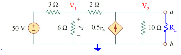

If I might offer up another approach that I thought of back in my school days (when dinosaurs ruled the Earth) and served me quite well for these sorts of circuit problems. I am sure is not unique since there are far more clever people than myself publishing circuit analysis methods, but I offer it up such as it is.
I considered the situation where a Thevenin source was driving a load resistance and how it was basically a voltage source with a source resistance and a load resistance in a voltage divider configuration:
##V_{ab} = V_{th} \frac{R_L}{R_L + R_{th}}##
So I thought to myself that if a circuit analysis could be made to determine the voltage across some arbitrary load resistance, that analysis should result in a formula that could be put into the form of a voltage divider equation from which you could pick out the Thevenin voltage and Thevenin resistance. Two birds with one stone, as it were.
Your circuit is one such circuit.
Let's add to your circuit a load resistance and choose the bottom rail as the reference node, then label the two essential nodes ##V_1## and ##V_2##, with ##V_2## being recognized as the output voltage ##V_{ab}##.
Employing nodal analysis, we can write:
For node ##(V_1)##:
##\frac{V_1-50}{3} + \frac{V_1}{6} + \frac{V_1 - V_2}{2} = 0##
so that:
##V_1 = \frac{50}{3} + \frac{1}{2} V_2##
For node ##V_2##:
##\frac{V_2 - V_1}{2} - \frac{1}{2} V_1 + \frac{V_2}{10} + \frac{V_2}{R_L} = 0~~~~~~## as vx = V1 given the chosen reference node
Collecting terms:
##\left( \frac{3}{5} + \frac{1}{R_L} \right) V_2 - V_1 = 0##
Substituting for ##V_1## from before,
##\left(\frac{3}{5} + \frac{1}{R_L} \right) V_2 - \left( \frac{50}{3} + \frac{1}{2} V_2 \right) = 0 ##
Solve for ##V_2##:
##V_2 = \frac{500}{3(R_L + 10)}R_L##
Adjusting the result to resemble a voltage divider equation:
##V_2 = \frac{500}{3} \frac{R_L}{R_L + 10}##
Comparing the result with voltage divider equation where a Thevenin source drives a load, we can easily pick out the Thevenin voltage and resistance:
##V_{th} = \frac{500}{3} V##
##R_{th} = 10 \Omega##
I hope that this contribution might prove helpful in your future studies.
