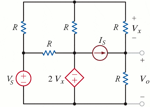

I am attempting to find Rth in the circuit attached however, I am totally lost. My work gets so messy and i seem to run around in circles. Can someone please explain to me how they would do this problem. Any help would be greatly appreciated

I'd do it the way the textbooks say ... open circuit current sources and close circuit voltage sources ... redraw the resulting circuit. If I'm reading that right, one of the resistors in in parallel with a short - so you can remove it.
i think for thevenin's with a dependent source, you first have to find vth and then you s/c where vth is and then find the current through I-s/c
after that then you get Rth = Vth/I-s/c

With this circuit you've basically got two options.
1. Leaving all the sources intact, firstly solve to find the open circuit voltage at "Vo", and then solve once more with the output terminals shorted to find the short circuit current. The open circuit voltage is your V_thv and the ratio of V_oc/I_sc is your Z_thv.

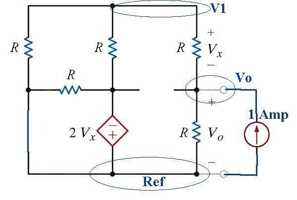

2. Set the independent sources to zero and apply an external 1 amp independent current source between the output terminals (directed toward the Vo +ive). Analyze using nodal analysis to determine the output voltage. The Thevenin resistance is numerically equal to this voltage.
Method 2, in my opinion, is the easiest way to solve this if you're trying to find R_thv alone. I got it down to just 2 nodes (apart from the ref node) and three equations.

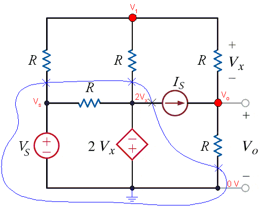

In nodal analysis, nodes that are directly connected by voltage sources are amalgamated into supernodes. The reference node is not immune to this procedure :wink:
Really sorry guys, just can not get this one out. Can someone please show me their node equations or other method. I keep getting the wrong answer for some reason. Thanks for your patience
Voltage sources between nodes form supernodes. Even controlled sources participate, and the reference node is not immune to this treatment.
A supernode can be identified as follows, leaving the indicated independent nodes:
You should be able to write the node equations, keeping in mind that Vx is equal to V1 - Vo.

Ok so i get:
Node 1: (Vs-V1)/R - (V1-2Vx)/R - (V1-Vo)/R = 0
Node 2: (V1-Vo)/R + Is - Vo/R
Which leaves me with V1 - Vo = Vs
and -V1 + 2Vo = Is*R
Have I done anything wrong?

This is the alternative method that I mentioned previously.
The circuit simplifies down quite a lot. The resistor in parallel with the voltage source goes. Then you can do a Norton's source transformation on dependent source and combine some parallel resistors to end up with a circuit having only three resistors and two nodes.
R_thv is numerically equal to Vo in the following circuit.
