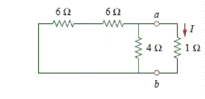

Calculating the Thevenin Resistance there I get 16Ω - the book however says it's 3Ω.
The way I see 3Ω being calculated is if 4Ω were in parallel with 6Ω + 6Ω - however they all appear to be in series. I'm assuming the 1Ω resistor is replaced by an open-circuit?
Suppressing the sources, the voltage source is replaced by a short and the current source is removed. How's it look now?

I'm still not seeing how that gives 3 ohms unless I take 12 in parallel with 4, ignoring 1 ohm resistor.
Since the 1 ohm resistor is the load, I thought we remove the load when calculating Thevenin Resistance?
Yes, remove the load and "look into" the circuit at the terminals where it was connected. Clearly the 6+6 = 12 Ohms is in parallel with the 4 Ohm resistor, no?
Ohhhhh...:cry:
I didn't keep the ends of the terminal when I first drew it, I just ignored it hence why I just added it in series, but now I see...thanks!

No, a current supply does not mean short circuit; A current supply will produce any potential difference across itself that is required to supply the mandated current value. The 18V supply will also contribute current to the circuit.

Current will flow in both loops. I'm puzzled how you could conclude it wouldn't? Only were the potential across the current source equal to +18V could there be no current through that 6Ω and its voltage source.
That 3A represents an independent current source, it's not an arrow marked on a short-circuit in the schematichttp://img851.imageshack.us/img851/3541/iconexclaim.gif

That's true, for student exercises for the most part we consider short-circuits as ideal ones. But it's a current source that's supplying current, not a short-circuit.
Ahh...I see. Current source makes all the difference. I guess we didn't study the difference between current source and voltage source in my college. Thank you, though..
