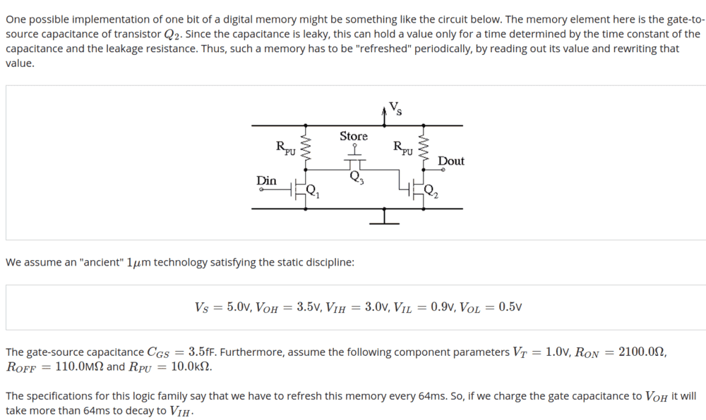

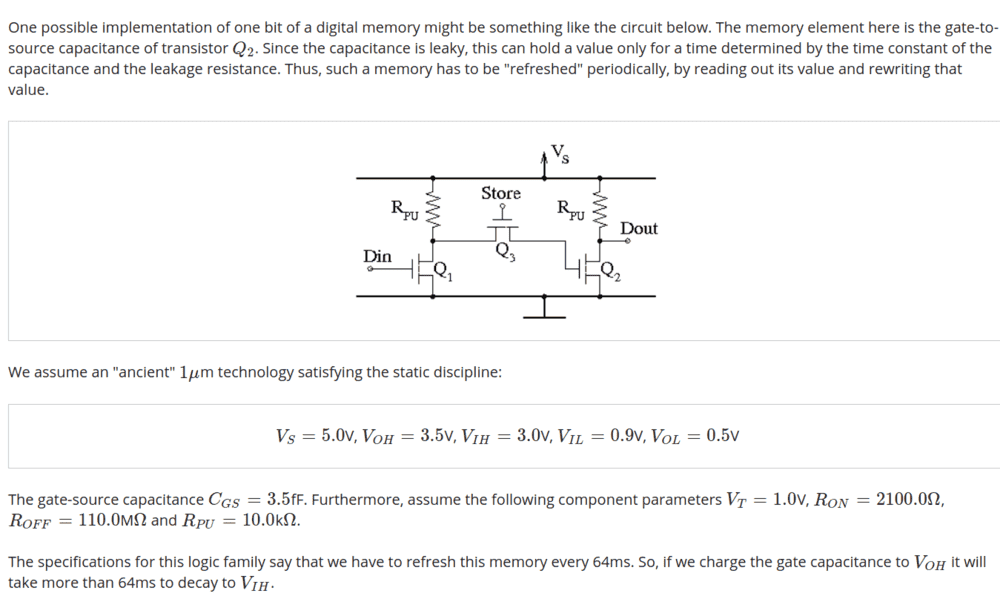

I have a problem which consist in 1 bit RAM made of 3 MOSFETs. One of the questions is to calculate the maximum voltage that the memory element can receive. I have obtained the result by inspection (it is 4 Volts) but I'm unable to reach the same by applying the Thevenin Theorem.

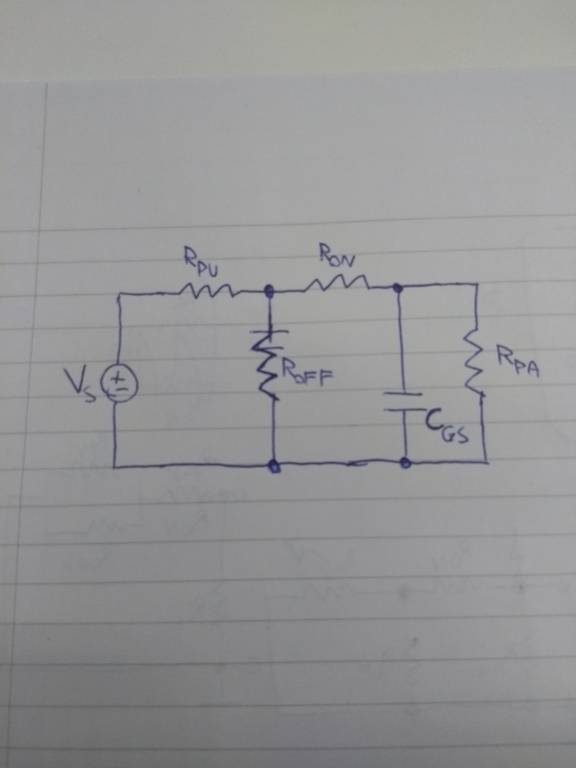

My understanding is: I have a circuit made of several resistors and one capacitor (which is the memory element). If the circuit is reduced to a $ (V_{TH}, R_{TH}) $ Thevening Equivalent, and given that the capacitor behaves like an open circuit for long periods of time (it's fully charged), I can assume that the maximum voltage the capacitor might have is $ V_{TH} $. The problem is that the $ V_{TH} $ I find has nothing to do with the expected result (4 Volts).
**I want to know what I'm doing wrong and how to solve this problem by applying the Thevenin theorem.**

Now, suppose the drain of Q1 is high, and the store line is held at the same voltage as the drain of Q1 . What is the maximum voltage, in Volts, that the gate of Q2 can be charged to? Note, this value must be larger than VOH = 3.5 Volts to satisfy the static discipline.

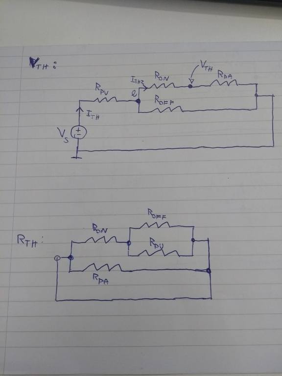

Now, my 'Tehevening Equivalent' attempt to find the voltage in Q2 is below:
parallel(R_{1}, R_{2}) = \frac{1.00000000000000}{\frac{1.00000000000000}{R_{1}} + \frac{1.00000000000000}{R_{2}}}
R_{\mathit{TH}} = {\rm parallel}\left(R_{\mathit{PA}}, R_{\mathit{ON}} + {\rm parallel}\left(R_{\mathit{OFF}}, R_{\mathit{PU}}\right)\right)
I_{\mathit{TH}} = \frac{V_{S}}{R_{\mathit{PU}} + {\rm parallel}\left(R_{\mathit{OFF}}, R_{\mathit{ON}} + R_{\mathit{PA}}\right)}
e = -I_{\mathit{TH}} R_{\mathit{PU}} + V_{S}
\mathit{ITH}_{2} = \frac{e}{R_{\mathit{ON}} + R_{\mathit{PA}}}
V_{\mathit{TH}} = -\mathit{ITH}_{2} R_{\mathit{ON}} + e

The final result (`V_TH`) I get is `4.99954549553765` Volts, and it should be 4 Volts.

Unnecessary complications. DC steady state solution is not applicable here because the circuit is semi-dynamic latch.
In time scale of interest, Vg(Q2)=Vs-Vt=5-1=4V. If for some reason the voltage Vg(Q2) will rise above 4V, the Q3 can no longer be opened by "Store" signal.
