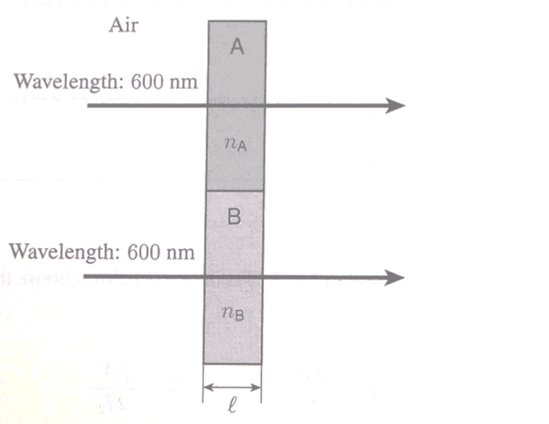

As shown in the figure below, beams of light whose wavelength in air is 600 nm are perpendicularly incident upon two transparent thin films (A and B) in the same phase. The thickness of A and B is l. The refractive indices of A and B are, respectively, nA and nB. The difference of these two indices (nA - nB) is 6.0 x 10-3, and the refractive index of air is 1.00.
What value should be assigned to film thickness l in order that the two beams of light directly passing through A and B, respectively, without reflection at the film – air boundaries are of opposite phase (i.e. phase difference corresponding to half a wavelength)?
phase difference = (2 x n x thickness) / λ - 1/2
What is the meaning of "in order that the two beams of light directly passing through A and B, respectively, without reflection at the film – air boundaries are of opposite phase (i.e. phase difference corresponding to half a wavelength)"?

So the question means that light 1 and 2 are in phase and light 3 and 4 are in phase, or light 1 is in phase with light 3 and light 2 is in phase with light 4? Or is it just the same for the two cases?
The two beams enter in phase and passes straight through the media. When they exit they will not be in phase anymore due to the optical path difference between the two media.

So the question compares the phase of light that passes through A and B, not comparing the light that reflected at the boundary of thin film - air?
Correct. The words in the question
seems to point to that, also the arrows going straight through the media.

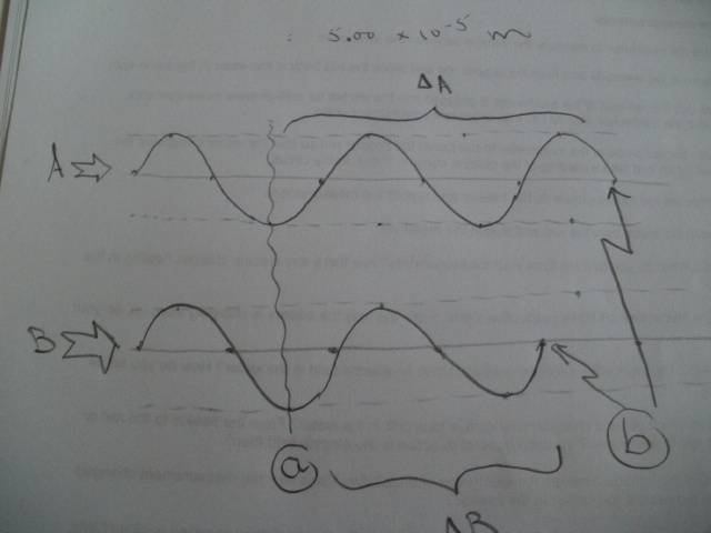

Let us try using number:
phase difference = optical path difference / wavelength
1/2 = L x 6.0 x 10-3 / (600 x 10-9)
L = 5 x 10-5
Is that correct?
Yes but give the answer to 3 significant digits plus units: L = 5.00 x 10-5 m
At (a) the beams enter the films and at (b) they exit at the same time.
The optical path for beam A traveling through the film is ΔA and for B it is ΔB.
They are not in phase when they exit due to the fact that the refractive indices and thus their speeds differ in the two films. Also their wavelengths will differ in the two films leading to different amount of wavelengths fitting in the films.
For A 1 and 3/4 wavelengths fit in L and for B 1 and 1/4 wavelengths. So when they exit B lags with 1/2 wavelength with respect to A.
