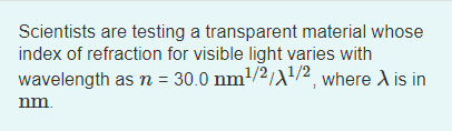

Scientists are testing a transparent material whose index of refraction for visible light varies with wavelength as n = 30.0 nm^(1/2)/λ^(1/2), where λ is in nm.
A 310-nm-thick coating is placed on glass (n = 1.50) what visible wavelengths will the reflected light have maximum constructive interference?
λ_constructive = (2nd)/m where m = 1,2,3,4
Δφ = 2π*(2nd)/λ
d is thickness of film[/B]
[/B]
I am really confused by the index of refraction notation n = 30.0 nm^(1/2)/λ^(1/2), but what I got out was that in the visible spectrum, n < 1. So you have air where n = 1. the film where n < 1, and glass where n = 1.5 . So light will reflect off the film with no phase difference, and light reflects off the glass with a phase shift of π. So the light has to travel 2d and have a phase shift of mπ (m = 1,3,5...) to have constructive interference.
π = 2π*(2 * (sqrt(30nm)/(sqrt(λ))) * 310nm) / λ
using a calculator I got λ = 358.6nm
using 3π, I got λ = 191.4nm which isn't in the visible spectrum
This answer is sadly wrong because the online answer box says there are two wavelengths that will have constructive interference.

The middle of the visible is ## \lambda=550 \, nm ##. There ## n \approx \frac{30}{23.5} \approx 1.3 ## by this formula. ## \\ ## And an additional hint: The index ## n ## of the film does obey ## 1<n<1.5 ##. This means that a ## \pi ## phase change will occur upon reflection at both the thin film/glass interface and also at the air/thin film interface, so that it can be ignored. ## \\ ## And your equation is correct for constructive interference: ## 2nd=m \lambda_{air} ##.
