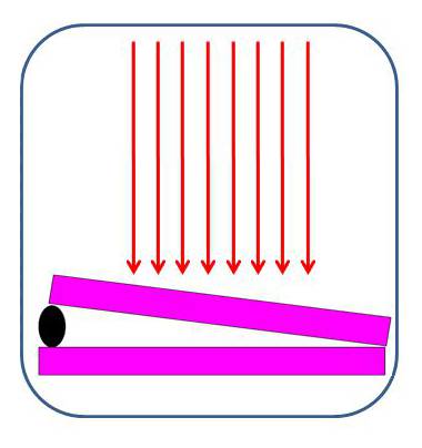

Two glass plaques of length 10.0 cm osculate, on one end, and are separated by a wire of diameter d = 0.0500 mm on the other. Light with two wavelengths (400 nm & 600 nm) falls on one of them, and we can see it gets reflected. At which distance from the point of contact does the next dark fringe form?
2nt = mλ
2nt = (m+1/2)λ
dsinθlight = mλ
dsinθdark = (m+1/2)λ
[/B]
My problem here is that I can't really understand the significance of the two wavelengths, how to use that info and generally how to proceed. My book has a small paragraph on TFI, and only explains the basic stuff (the above formulas for a single instance and that's it). Anyway, I figured:
>d = t : So d, the diameter, plays the role of the thin film's thickness.
>The thin film is the air, and the glass plaques have the same ng, which while bigger than n = 1.00 of the air, is still the same from above and bellow the thin film/air, so I don't have to inverse the two formulas.
>So, 2nt = mλ for destructive confluence, and 2nt = (m+1/2)λ for amplified confluence.
Now, the only thing I came up with was: Take the first formula (for destruction) and try it with both λs, to see which one gives me an integer m. 400 gives me n = 250, whereas 600 gives me 166.6666...7. So, I figured I'd continue with the first wavelength. Then I went back to the chapter about light and dark fringes, and looked at the formulas.
Now it gets murky and I'm just throwing stuff at the wall to see what will stick, but my plan was to put in the data in the "dark fringe" equation, find the angle, then put it in tanθ = y/L and find y. But that didn't work out. So I need some help here.
Any help is appreciated!
Hmmm ... it does seem as if you are throwing stuff against the wall as you say. You only need your second equation, and the point is t varies from one edge of the plate to the other. You can use the information given to parameterize t as a function of position along the plate.
The two wavelengths give an additional constraint. For a dark fringe they both have to be dark at the same location.

You don't need to. First find the minimum separation at which it is all dark, then convert to a distance from the end.
Darthkostis said:
Do I take the equation two times, once with 400 & once with 600 ?
Yes. You can find all the separations at which one will be dark, and all the separations at which the other will be dark. Then figure out where both will be.

I looked at it again, but I can't come up with something. How do I translate "everything is dark" to the 2nt = mλ formula? λ is the wavelength, t is the gap/seperation, n is a constant (1.00 since the thin film is the air here), which leaves m.
If we just stick with one wavelength for the moment, the formula tells you for which values of t it will be dark. Just plug in m=1, 2, ... and solve.
Are you asking why that is true?
Putting in the other wavelength gives a different set of values of t. The question is asking for the smallest value of t (and hence of d) which is dark for both.

To be honest, I'm not really sure what it means. The "question" itself from the book is: "at which distance, from the point of contact, does the next dark fringe form". I took it to mean as "how far from the right side is the next dark fringe", but what does "next dark fringe" mean?
Darthkostis said:
I get t = 600 nm for m = 3 for the λ = 400 nm, and t = 600 nm for m = 2 for the λ = 600 nm. Is that it?
Looks right to me. What does that correspond to as a distance from where the plates meet?

Because of the 180 degree phase difference, the point where the plates meet will be a dark fringe for both wavelengths. You want the next such along.

Because of the phase change of the ray reflected from the top surface of the bottom plate dark fringes (lines) are centred at places where the path difference (2t) = 0 or an integral number of wavelengths.
Each wavelength produces its own interference pattern and these two patterns overlap.
The resultant pattern can be rather complicated, for example there will be places where a bright fringe from one wavelength overlaps a dark fringe from the second wavelength. The result is that a fairly bright fringe is seen.
But there will also be places where two bright fringes overlap to make a brighter fringe.
And there will be places where two dark fringes overlap resulting in a dark fringe.
The question is about the dark fringes. Along the line of contact the path difference is zero for both wavelengths and that's where the first dark fringe is observed.
As you move to the left you can reach places where both wavelengths produces other dark fringes, the resultant fringe being dark.
Basically the question is asking you to find the second place at which this happens, the first place being along the line of contact.
But remember m, as in your equation, will have different values for each wavelength. I suggest that you use m for one wavelength, as you have done already, and a different symbol, for example n, for the second wavelength.

Thanks a lot for the info and help! It seems the wording of the questiong messed me up a bit. Here's the completed exercise:
>Same kind of materialabove and bellow the air.
>Thus 2nt = mλ is the formula for the dark fringes.
>We're looking for the minimal "t" (height/gap/seperation between the two plaques) for which both wavelengths produce a dark fringe.
λ1: t = m*200 nm
For m = 1: t = 200 nm
For m = 2: t = 400 nm
For m = 3: t = 600 nm
λ2: t = n*300 nm
For m = 1: t = 300 nm
For m = 2: t = 600 nm
>So t = 600 nm is the minimal one.
Now, the two plaques create an tiny angle between them, close to the point of contact, which we can find.
tanθ = d/L <=> ... <=> θ = 5*10-4 rad
The angle remains the same, and using it and the minimal t, we can find how faritis from the point of contact.
tanθ = t/l <=> ... <=> t = 1.20 mm (which is the book's answer)
Thanks a ton for the help and patience everybody!
