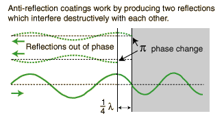

Before I comment much, perhaps the easiest way to solve this problem is to look in your textbook or coursework for a particular formula that will help you with this.
That said, the ideal thickness of the film for an anti-reflective layer is [itex] \frac{1}{4} \lambda_{\mathrm{film}} [/itex]. The reason for the 1/4 wavelength is that the wave that is reflected from the back of the coating layer will then be 1/2 wavelength out of phase with the wave that gets reflected off the front of the coating. (The wave that travels through the coating and gets reflected off the back of the coating, travels a total of [itex] \frac{1}{4} \lambda_{\mathrm{film}} + \frac{1}{4} \lambda_{\mathrm{film}} = \frac{1}{2} \lambda_{\mathrm{film}}[/itex] within the layer, total). In front of the coating (in the air) there will be two reflected waves. Since the two reflected waves are 180o out of phase, they destructively interfere with each other.
With that piece of knowledge, and one of the things listed in your relevant equations, you'll have enough information to derive the appropriate formula yourself. :wink:

It is important at least qualitatively though. It's important to know qualitatively that the index of refraction of the coating layer is less than the index of refraction of the glass. If it were the other way around, the wave reflected from the layer off the glass gets an inversion upon reflection: it would change the equations. Also, given the choice is better to choose an index of refraction of the coating the be the geometrical mean of the glass and the air indexes of refraction, to promote reflections with equal intensity. But don't worry about that for this problem; this problem has more to do with the coating layer's thickness.
The constraint which you are working with is that the layer of coating has a fixed thickness of 120 nm. You can't change that. The thickness and the coating layer's index of refraction determine the target wavelength.
or
t=120nm
or how to find the wavelength of the film.
120 nm = (1/4)λfilm
This link might be of some help regarding where the 1/4 factor comes from:
http://hyperphysics.phy-astr.gsu.edu/hbase/phyopt/antiref.html#c3
