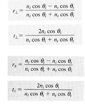

I am working on a thin film interference problem where i have to find the phase difference. What is the relationship between external/internal reflection and the thin film interference
for external:
[/B]

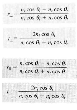

for internal:
So far i have that the DOPL=2dncosΘt
d being the thickness of the film

Internal means going from high index to low index: i.e. Leaving the film going into air. External is the opposite. The equations you posted show the magnitude of how much is reflected vs transmitted. The parallel and perpendicular symbols refer to the polarization of the light: parallel or perpendicular to the plane of incidence. None of that has anything to do with finding the relative phase.
