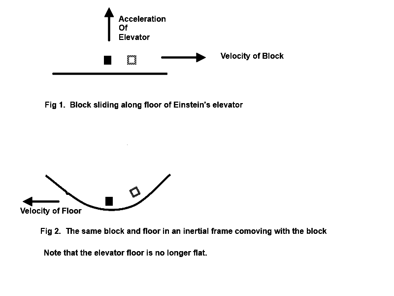

In a different thread the Herglotz Noether theorem was brought up and it was mentioned that this theory implies it is impossible for a cylinder rotating about its vertical axis to remain Born rigid in a gravitational field even at constant altitude. This is an extension of the claim that a Born rigid rotating disc cannot have linear acceleration and remain Born rigid. Now I accept and understand that:
1) A non rotating disc cannot be spun up and remain born rigid during the angular acceleration phase.
2) A vertical rotating cylinder that descends in a gravitational field cannot remain Born rigid.
What I do not understand is why a vertical cylinder rotating around its vertical axis cannot remain Born rigid if its rotation is constant and it remains at constant altitude in a gravitational field.
To try and break the problem down to its simplest elements, I would like to initially discuss/analyse the dynamics of an infinitesimally thin disc in the y/z plane that is rotating about the x axis, that experiences constant proper acceleration in the x direction.
First, in the context of artificial acceleration in flat (Minkowski) spacetime, the disc would appear to have increasing velocity in the x direction in a given inertial reference frame. To make discussion easier I will identify my statements/assumptions/considerations with letters.
a) I think we can also assume that as the velocity increases in the x direction, the rotation of the disc will slow down in proportion to the time dilation factor.
b) To an accelerating observer that remains at the centre of the disc, the rotation rate will appear to remain constant.
c) In the inertial reference frame, the increasing linear velocity and corresponding angular velocity slow down of the disc, implies that the radius and perimeter of the disc has to increase if the perimeter length of the disc is to remain constant as measured by observers on the rotating disc.
d) If (d) is true, then by the equivalence principle. this implies that a thin disc with constant rotation at constant altitude will expand or rip itself apart (if Born rigidity is not maintained). As far as I aware this effect as not been observed in everyday life or in a lab.
e) It may be that the expansion in consideration (c) does not occur. Study of successive Lorentz transformations of a rod shows that if the first transformation (to S') is parallel to the rod (say in the x direction) and the second (to S'') is orthogonal to the rod (say in the y direction), then Thomas precession does not occur and the length of the rod as measured in S'' is independent of the velocity component in the y direction and equal to the length of the rod as measured in the S' reference frame. This implies that if the disc is already rotating in the y,z plane about the x axis, and the constant linear acceleration is along the x-axis (or upwards in a gravitational field) then length contraction effects above and beyond those already present due the rotation of the disc, should not occur.
OK, that's enough musings for now. Can anyone correct/expand on my thoughts here and explain what exactly happens in the special case of a infinitesimally thin disc that is rotating with constant angular velocity and linearly accelerated with constant proper acceleration along its rotation axis?
No, it implies that a thin disk with constant rotation and constant altitude will experience shear stresses that will not be present in an accelerated disk that is not rotating, or a rotating disk that is not accelerated. The shear stresses would not necessarily have to exceed the breaking stress of the material.
These stresses could in principle be measured in a lab, but I think (though I haven't run any actual numbers) that with a 1 g acceleration, in order to make the additional shear stress measurable you would need to have an angular velocity well beyond what we could achieve with known materials (i.e., the disk would tear itself apart purely due to the stresses induced by trying to spin it up, even if it was freely falling, so we would never get to the point where we had it in a state where we could test for the additional shear stress due to the combination of rotation and acceleration).

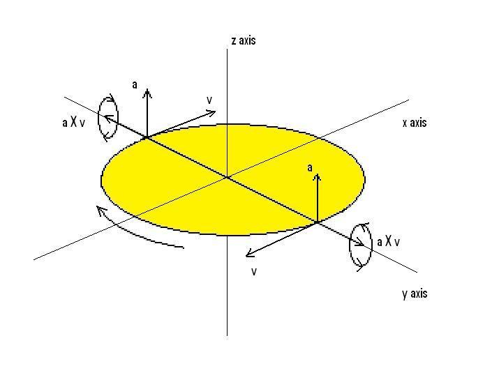

If we accelerate the disc linearly in the x direction and THEN rotate it around the x axis, then when looking at a short section on the edge of the disc, Thomas precession tends to twist that section out of the rotation plane.
This isn't the way I understand Thomas precession. [Edit: Actually I missed something here--see follow-up post.] First, Thomas precession doesn't cause stress within a rotating disc; it's just a way of expressing what "non-rotating" actually means, in terms of Fermi-Walker transport. Second, Thomas precession acts wholly within the rotation plane of the disc.
Here's a way to visualize what Thomas precession means. Suppose I put a gyroscope on the edge of a rotating disc, supported by a frictionless bearing so that the gyro's orientation is not affected by the motion of the disc itself (the bearing applies a force at the gyro's center of mass to keep it riding around with the disc). At some time t = 0, the gyro is pointing directly at some distant object (such as a star), which is at rest relative to infinity.
If Newtonian physics were exactly correct, the gyro would remain pointing at the distant star forever, as it rode around on the edge of the disc. However, when we take relativity into account, the gyro will slowly precess in the retrograde direction: that is, the direction it points will slowly rotate, relative to the distant star, in the same plane as the disc itself, but in the opposite direction.
Now, suppose we paint a radial stripe on the disc; this stripe defines a spatial vector that always points "radially outward" relative to the disc. Suppose the outer end of this stripe passes directly underneath the gyro, and everything is transparent so we can see the relative orientation of the gyro and the stripe from above. If we look down from above, as the disc rotates and the gyro rides around on its edge, we will see the gyro and the stripe rotating relative to each other. However, there will be no stress in the tangential direction due to this relative rotation; the only stress, on either the disc itself or the gyro, is radially inward (because that's the direction of the proper acceleration).

Thinking this over, I think it can't be, and the difference might be what yuiop was referring to when talking about "twisting" the disk out of its rotation plane.
If the disk's CoM is moving inertially, then a point on the edge of the disk is subjected to Lorentz boosts all in the same plane, but with changing direction within that plane. So the resultant of the successive boosts will be a rotation about an axis perpendicular to the plane.
However, if the disk's CoM is being accelerated in a direction perpendicular to the plane of rotation, then a point on the edge of the disk is subjected to Lorentz boosts with two components, the one due to rotation, within the plane, and the one due to linear acceleration, perpendicular to the plane. Also, the 3-velocity of a point on the disk's edge is has a component within the plane of rotation and a component perpendicular to that plane (at least, it does once the disk has accelerated for more than an instant relative to a given inertial frame). So the cross product between the velocity and the acceleration vectors, and the magnitude of the velocity vector, will both change, and since those are what determine the Thomas precession, the latter will also change. (This means it will also change with time, as the disk accelerates.)

if we rotate the disc first and THEN accelerate linearly along the rotation axis, there is no Thomas precession effect.
I don't think this can be right; if the disk is rotating while it is being linearly accelerated, then the argument in my previous post applies and Thomas precession must be (a) present, (b) not the same as for the case of a rotating disk whose CoM moves inertially, and (c) changing with respect to time.
I'm not sure, however, how any of this relates to stresses in the disk; as I said a couple of posts ago, Thomas precession by itself doesn't cause any stresses, it's just a definition of what a "non-rotating frame" means (more precisely, it defines how a local definition of a "non-rotating frame", using gyroscopes, *differs* from the Newtonian expectation that such a frame should always point to exactly the same location at infinity).

I've been busy recently, but had a few thoughts on the topic.
It's helpful to consider the case of a block sliding along the floor of an Einstein's elevator before tackling the rotating case. There is some discussion by me in another thread https://www.physicsforums.com/showthread.php?t=701257, the discussion includes a derivation of the trajectory of the moving block in an inertial frame, and a convenient set of coordinate transforms and an associated metric.
It's a bit sketchy, but the supporting math is there, though the "convenient" coordinates aren't Fermi-normal coordinates. One could get Fermi-normal coordinates at the expense of making the metric time dependent, but I'll leave that to the interested reader (my personal guess is that the approach I took will be easier to manage and understand).
I'll summarize the results a bit less mathematically.
In Fig 1, we see the usual picture of the block sliding along the elevator floor. The solid and hatched block represents the position of the block at two different times.
A gyroscope attached to the block will rotate, because of effects similar to Thomas precession, whose axis is in the a (cross) v plane, cross being the vector cross product. The plane of rotation is the a^v plane, i.e. it is the plane formed by the accleration vector and the the velocity vector. It's not particularly obvious why the block is rotating viewing this diagram.
In Fig 2, we see the block in an instantaneously co-moving inertial frame. The elevator floor now appears curved, due to the relativity of simultaneity. The block is stationary, and the floor slides in the other direction, without rotation. The block itself rotates so that it's bottom of the block is always parallel to the curved floor - this is again due to Thomas precession, it's not caused by any torque from the floor. It's a bit more obvious in this diagram why the block must rotate.
The main effect of the motion of the block as far as dynamics go will be an increase in its weight.
If we consider the rotating disk case now, I believe the following should be true (I haven't done separate detailed calcuations)
1) We will have the same increase in weight at the edge of the disk relative to the center of the disk. This could be regarded as stresses on the disk (though the stresses will be immediately translated to the floor).
2) There will be additional Thomas precession due to the centripetal acceleration and the velocity of the disk (one might argue that this is in fact the true meaning of Thomas precession). This will induce some stress on the disk as well, though I find it difficult to vizulaize the details. However, these stresses would be present in a rotating disk that was NOT in an Einstein's elevator, so I don't think these stresses are of interest to the Born rigidity question.
I don't see, at the moment, a source for any other stresses than 1) and 2).

  • #34
All your inputs are gratefully received and worth any wait :approve:
This is a useful simplification that may assist in resolving the question raised in this thread. Your metric is interesting although I have not fully grasped it yet. Can you confirm that the the proper length of the block along the x-axis remains constant or are their issues with rotation that make this unclear?
This is exactly the precession I was trying to describe in the last paragraph of post #9. I have attached a diagram to show the various vectors you describe as applied to the rotating disc. It is easy to see from the diagram that the Thomas rotation effect of opposing sides of the disc counteract each other and there is no net rotation of the disc, although there may still be additional internal stresses induced within the disc as a result.
Agree. With a properly supported disc on suitable bearings, this should have no effect on the geometry or Born rigidity of the disc.
Again I agree. It is difficult to see any intuitive reason why a disc with constant angular velocity, at constant altitude with constant proper linear acceleration should have a breakdown of Born rigidity.
