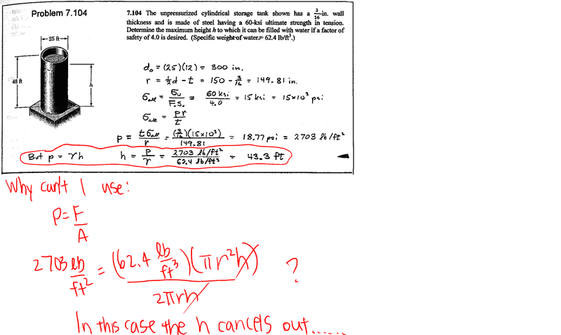

Here is the problem and the solution
Why does P=F/A not work?
