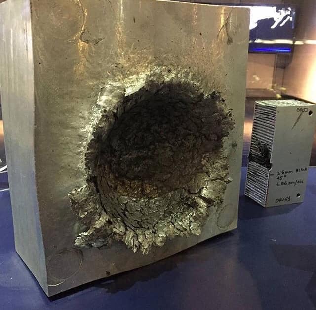

I have seen this image - and its claim - dozens of times over the last year. I have yet to find a reliable source of its authenticity.
This is a test, done here on Earth, under optimal conditions, not an actual impact in space.
"An anonymous user on Reddit, who apparently works in the aerospace field, posted an image of what a 1/2oz of space debris can do to a block of solid aluminum. This test was done by a light-gas gun in close quarters and shows how much damage even a tiny amount of space debris can do: "
https://bigthink.com/news/heres-the-damage-a-tiny-speck-of-space-debris-can-do-at-15000mphBTW, because of the lens, the pic looks darned impressive, but the crater is (only) 5 inches deep. That makes it about 10 inches across.

Even tiny objects that weigh hardly anything can become extremely powerful projectiles at hypervelocity.
That half-ounce piece of plastic probably packed a many times more kinetic energy than a bullet fired from a 50-caliber rifle.

The article referenced states that the damage was done by an object the size and weight of a pencil eraser. It may be the size of a pencil eraser but at 0.5 oz or 14.2 grams its mass is close to a 0.45 ACP (automatic colt pistol) bullet at 15 grams. Bang.

The damage is proportional to the Kinetic energy imparted:
KE = 1/2 m v2...
so i ran the numbers & unfort the Physics doesn't add up.
(NB: 15000mph = 6705.6 meters/sec)
KE = 1/2 x 0.014kg x (6705 x 6705)
= 1/2 x 0.014 x 44 957 025
= 1/2 x 629 398.35
= 314 699 Joules
So it's only:
314.699kJ = 75.3 calories = 0.0875 Kilowatt Hours or
in other words; enough energy to run your 1000W (1kW) radiator
for 0.0875 of an hour...5.25mins
(or for comparison: 564 calories in a Big Mac... so about 1/8th of a burger)
I severely doubt that is enough energy
to spiflicate a solid block of Aluminium like that!

You are thinking about this wrong. 315 kJ corresponds to .16 lbs of tnt. It is a lot of energy.yelelafella said:No way!

A bit of a units (math?) error there.
315 kJ ≈ 75 300 calories.
(food calories are actually kilocalories)
Density of Aluminum: 2.7g/cc
Specific Heat of Aluminum: 0.89J/g
Melting point of Aluminum: 660C
(660 - 20) * 0.89 = 570J/g
Heat of fusion for Aluminum: 380J/g
315 000/(570 + 380) = 332g (or 123cc) of Aluminum is liquified
Heat of vaporization for Aluminum: 11 370J/g
315 000/(570 + 380 + 11 370) = 25.6g (or 9.5cc) of Aluminum is vaporized

Before anyone asks, melt and vaporization are a small percentage of crater volume. Most of it is from deformation and failure.Tom.G said:25.6g (or 9.5cc) of Aluminum is vaporized

That's not all that was spificated.yelelafella said:No way!
KE = 1/2 m v2...
= 1/2 x 629 398.35
= 314 699 Joules
So it's only:
The reddit poster doesn't know his conversions from metric to english
The crater is much more to be 5cm dia ( multipying by 2 doesn't give 10 inches )
Not so sure about the mass of the projectile, but it could be 14g
Anyways, find the volume of the crater, find the energy to melt that amount of Al, and your 315J should in the ballpark.
@Frabjous I did say ballpark.

To put it in perspective, TNT with a density of 1.65 gm/cc, for 75gms, is a cube about 3.5 cm on a side.Frabjous said:You are thinking about this wrong. 315 kJ corresponds to .16 lbs of tnt. It is a lot of energy.

Some experimental data points:
Lead bullet at 1000 FPS on a solid steel plate splashes without denting the plate.
Lead bullet at 2000 FPS on a 2" thick solid steel plate makes a crater that my little finger tip fits into. And some of the lead splashes almost straight back. There are significant challenges making lead bullets work at that velocity, but handloaders like to do this sort of thing. Not me, but I was there.
It is easier to understand the dynamics of high speed impact if you assume that the projectile is a liquid, calculate the velocity pressure (##0.5 * \rho * V^2##), and compare to the compressive strength of the projectile.

They may have used Al for effect. Also, we do not know what alloy of Al was used. Even among Al alloys, there is a significant difference in strength. If they had used Stainless Steel for example the results would not have been as dramatic. SS has 3 to 4 times the tensile strength of Al alloys plus it is twice as dense and has a melting point twice that of Al. Anyway, it would be interesting to see what would have happened.

I dug up a scaling law for geomaterials, (ρY3)-.25, and it predicted a new crater volume equal to V0/3.7. If one assumes that it retains the same shape, the new lengths are l0/1.5.gleem said:They may have used Al for effect. Also, we do not know what alloy of Al was used. Even among Al alloys, there is a significant difference in strength. If they had used Stainless Steel for example the results would not have been as dramatic. SS has 3 to 4 times the tensile strength of Al alloys plus it is twice as dense and has a melting point twice that of Al. Anyway, it would be interesting to see what would have happened.

Definitely late to the party, but I suspect the use of aluminum is because that's a very commonly used spaceframe material. Much of the ISS structure is aluminum alloys, iirc.gleem said:They may have used Al for effect. Also, we do not know what alloy of Al was used. Even among Al alloys, there is a significant difference in strength. If they had used Stainless Steel for example the results would not have been as dramatic. SS has 3 to 4 times the tensile strength of Al alloys plus it is twice as dense and has a melting point twice that of Al. Anyway, it would be interesting to see what would have happened.
