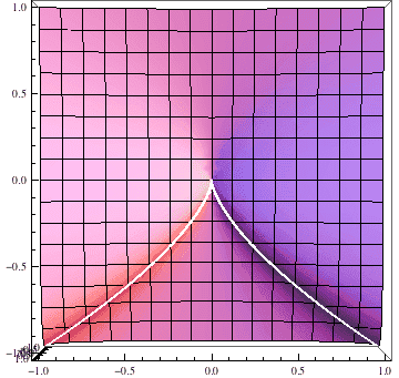

When you write[tex]F_y(x,y) = \frac{y^2}{(x^2+y^3)^{2/3}}[/tex]you're assuming that [itex]x^2+y^3\ne 0[/itex]. That's why you can't just naively differentiate and plug in x=y=0 to find [itex]\partial F/\partial y[/itex] at (0,0). Instead, you have to do what they did in the solution and what SammyS explained back in post #4.
I've attached plots using F(x,y) below. The first one is a top view where you're looking down at the surface from a point on the z-axis. The white stripe corresponds to the curve x2+y3=0, which is where the F(x,y) is not differentiable. The second plot is a side view from a point on the x-axis, and the front edge is in the yz-plane. You can see the slope of the edge is constant. This is because ∂F/∂y(0,y) equals 1 for all y. The last plot is of the intersection of the surface with the xz-plane. You can see there's a cusp at the origin, so ∂F/∂x doesn't exist at the origin.
Do you mean this part?
[PLAIN]http://img571.imageshack.us/img571/5297/xview.png
I'm not sure that was your question, but that's what I think you were asking.
Nope that was my question! I'll do my best to look up the definitions, but my theory is that there are no side limits.
