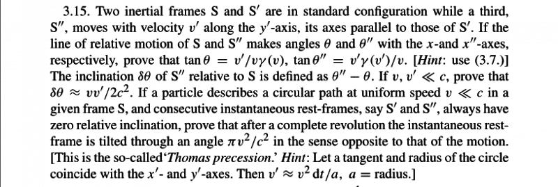

I suggest working through the following exercise (Rindler "Relativity: Special, General, and Cosmological" 2nd edition):
What I notice in looking at this exercise is that what Rindler does is very similar to Eisberg and along the same lines as Goldstein. He gets the answer [itex]\delta \theta \approx vv'/2{c^2}[/itex] for the inclination [itex]\delta \theta [/itex] of S'' with respect to S caused by two non-collinear boosts. Notice that he doesn't define the orientation of the spin as being in any particular direction. In fact Rindler assumes that irrespective of the position of the spin along the circle (and therefore irrespective of its orientation with respect to the circle) the inclination, [itex]\delta \theta [/itex], of S'' with respect to S caused by two non-collinear boosts is the same. This allows him to multiply [itex]\delta \theta [/itex] by the period to find the total change in inclination for a complete circuit. He doesn't do any averaging to get his answer. On the other hand Taylor and Wheeler end up with the formula [itex]\tan (d\phi ) \approx d\phi \approx - {\beta _r}^2\sin \alpha [/itex] (see a few lines after equation 130). [itex]d\phi [/itex] is the same as Rindler's [itex]\delta \theta [/itex]. The magnitude of [itex]{\beta _r}[/itex] is essentially Rindler's v/c and [itex]{\beta _r}\sin \alpha [/itex] is Rindler's v'/c. So, in Rindler's terminology, Taylor and Wheeler find that when the spin is oriented along the direction of motion the change after the two non-collinear boosts is [itex]{\rm{vv'}}/{c^2}[/itex] Now, Taylor and Wheeler do the averaging of the spin orientation as the spin is taken around the circular path (because sometimes the spin is parallel to the direction of motion and sometimes it's perpendicular and sometimes it's in between and it matters in terms of the resulting inclination after the boosts). It is that averaging that results in the same final formula as Rindler gets for the total change of inclination [itex]{\frac{{\pi v}}{{{c^2}}}^2}[/itex] (see eq. 133). I don't see how you can explain away the factor of 2 difference between Taylor/Wheeler and Rindler as being due to one of them doing a relativistic calculation. It still seems to me that there's a disagreement of some sort and I'm not sure how to resolve it. I don't see any averaging in the Rindler calculation and I don't understand where and how you would put it into that calculation.
