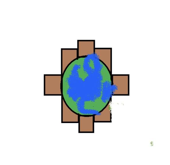

My friend has read your replies and insists you are mistaken and had sent me 2 (badly drawn) diagrams proving he is correct lol I will add them below, he said in the first one the bricks go inside the Earth and therefore the number of bricks would be equal then he offered an alternate suggestion which he prefers

The attached diagrams have no discernible relation to the scenarios as-written in earlier posts.
Either you and your friend do not have a meeting of the minds, or you are describing the scenarios incorrectly.
We cannot adjudicate your argument without an accurate description of your scenarios - and your diagrams contradict those scenarios.

I still haven't been able to figure out his original problem statement, let alone his latest figures. An accurate drawing would have been a big help in his first post, but I guess that was too much trouble...
