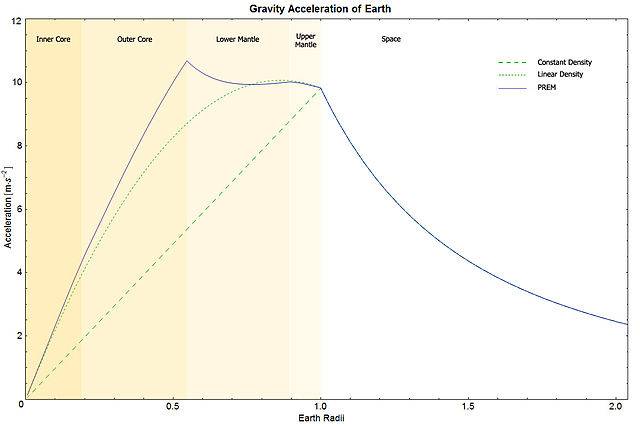

Mark44's answer is correct assuming an idealised Earth that is the same density all the way down. The actual Earth is denser at the core, and in fact gravity increases as you go down because you are getting closer to the dense core, until you get close to the core. Then the effect Mark44 is talking about starts to dominate and gravity drops to zero at the centre.

Here's a graph comparing how gravity would change with depth according to three different models for its interior: constant density, Density that increases linearly as you move towards the center, and Our estimate of what is is for the real Earth (Preliminary Reference Earth Model,or PREM)
