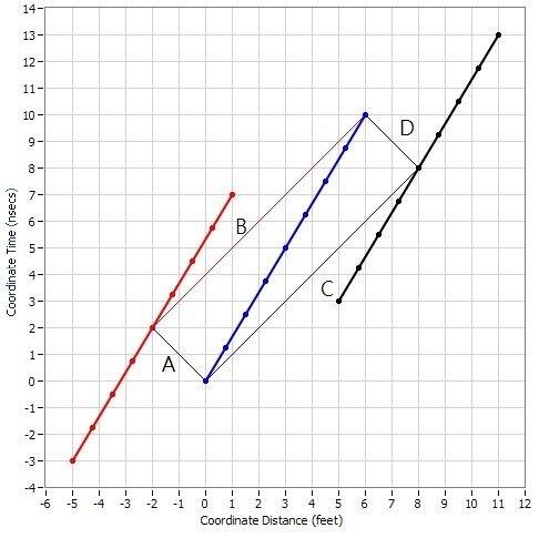

I have made a spacetime diagram to illustrate your scenario in the frame of the train car:
The thick blue line represents the light source, the time detector and the explosion system in the center of the train car. At the Coordinate Time of zero, the light source emits two signals, shown as thin blue lines, in opposite directions that travel at 1 foot per nanosecond (the speed of light) and hit the two detectors shown as the thick black and red lines, each four feet away from the light source. The detectors each send an electrical signal shown as thin lines in their respective colors which, for simplicity we will assume also travel at the speed of light, back to the time detector. As you can see, they arrive at the thick blue line at the same time and the explosion occurs.

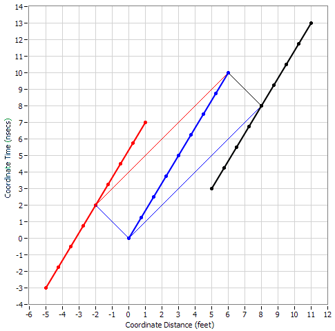

Now to see what this scenario looks like in a frame such that the train is traveling at a speed of 0.6 feet per seconds, we use the Lorentz Transformation process to obtain a new set of coordinates for each of the events (dots) and connect the lines appropriately:
As you can see, the two electrical signals arrive at the time detector at the same time and so the explosion occurs.
Does this make perfect sense to you? Any questions?
I understood now.
What I have overlooked is the wire
Your graph makes perfect to me. I can think it intuitively by your graph. Like Path A takes less time but the light has to use more time to chase back in Path B. Path C initially takes more time to detector but quickly goes back to center because the train is going toward.
