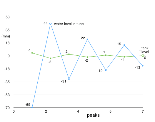

From my experiment, proposed by Dale and Khashishi, yes.
I read somewhere that straws are bad for the environment, so I used an ≈40 year old fish tank under-gravel filter tube:
total length: 220 mm
inner diameter: 20 mm
immersion depth: 69 mm (3 run average when eyeballing for 70 mm)​
So my tube extends both below and above the surface of my artificial ocean(a pint glass).
Somewhat different, but my experiment, when the tube top was at the waterline, clearly showed that water squirted out the top.
Anyways, here are the results of my experiment:
For a frictionless tube and an incompressible fluid, free of viscosity one would expect simple harmonic motion with a peak as far above the surface as the starting point was below.
Likes sophiecentaur, OmCheeto and Bystander
