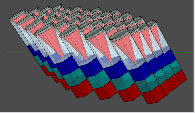

Although the amount of energy transmitted would be the same, the quality of the phased array central spot size will be negetively effected. According to this powerpoint presentation, there is something called the fill factor, which depend a lot on how close the lasers are position from each other. Only if they can manage a high fill factor, most of the enrgy can be focusted and therefore deliver effective force to the laser sail. The problem to achieving a high fill factor is that the phased array will not be able to supply powr to low elivations as there is simply noo room.
