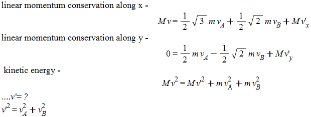

Ball of mass M collide two balls of mass m , elastic collision .
initially, M has velocity v , and two balls are stationary.
after the collision the two masses move ,like in figure , v_a , v_b /
What is the velocity V ,of mass M after the collision ?
try to manipulate the equations , with no success.
help

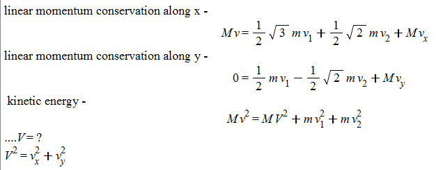

Your notation is a bit confusing, but I think I get it.
Consider that you have four scalar unknowns (vx, vy, v1, and v2) but only three equations.
fix notation
The way I read it, vA, vB are given, so it's 3 equations and 2 unknowns. Still not good. Could choose to ignore the elasticity condition.
momo, are you sure you have quoted the question exactly?
I assume your last equation in post #3 should read v'2=v'x2+v'y2.
