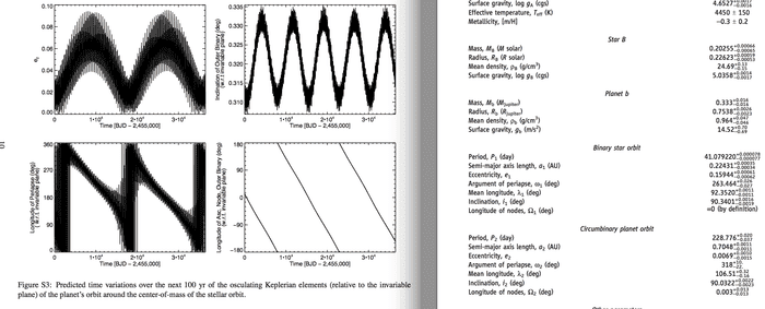

Hello,
I have a little three-body (well n-body but let's just worry about 3 now) simulator. I input six Keplerian orbital elements (period P, eccentricity E, inclination I, longitude of the ascending node W, argument of periapse w and initial true anomaly f). They then get converted to Cartesian coordinates and integrated using a simple RK4.
A problem, however, is the plane with which the angles are measured with respect to. I also have code that converts from Cartesian back to orbital elements, so I can see how they progress over time. This seems to be with respect to the invariable plane though, which is the plane of the total angular momentum of the system (and due to conservation of angular momentum it will not change).
When comparing my results to papers, I see I am using the invariable plane as the reference. I am able to successfully go from orbital elements -> Cartesian -> orbital elements and recover them, which makes me believe I am both inputting and outputting the orbital elements with respect to the invariable plane.
What I want though is to use the plane of the sky, which is how orbital elements are defined in exoplanet papers since we measure the orbits...in the sky. I think it would be just a rotation between the two but I am not sure what it is exactly and my tests so far have failed. I have also looked a fair bit online but not seen what the transformation is. Quite possibly it's simple and I just made an error, but I am not sure.
Kind regards in advance,
Dave

I am looking at the orbits of exoplanets.
I understand Ipetrich the invariable plane, as that is what the orbital elements are currently defined with respect to in my program, but I want to be able to input the orbital elements as seen in discovery papers.
For example, by taking the X-Y plane as that of the sky, a transiting exoplanet will have have an inclination of ~90, but with respect to the invariable plane it will have an inclination of ~0
I want to know how to convert between the two. I have attached a screenshot from the Kepler 16 transiting circumbinary paper, and its supplementary online material. In the discovery paper (on the right) you see the sky-plane coordinates, with an inclination of ~90. On the left you see the variation in orbital elements over time with respect to the invariable plane, where the inclination is now ~0. I just don't know what the conversion is :(
AussieDave, I think that you ought to look for stuff on binary-star coordinate systems. Details should be easy to find, and exoplanet orbits use the same conventions as binary-star orbits. The inclinations are relative to the plane of the sky (our sky, of course), but I'd have to look up further details.
Direct detection (Fomalhaut B) and astrometric detection (Barnard's Star's now-discredited planets) are like visual binaries. They can get all six elements, though the inclination has a sign ambiguity, and the semimajor axis is angular and may be multiplied by (planet mass) / (star mass).
Radial-velocity and transit detections are like spectroscopic and eclipsing binaries. Radial velocity cannot get the orbit inclination, though transit detection can. Nether method can get how the orbit is rotated along the line of sight to the system.
Also, could you please shrink your inlined image a bit? Half its current width would be OK. It's currently at 2298*930 pixels. I ask that because your image messes up the formatting and makes this page hard to read.
