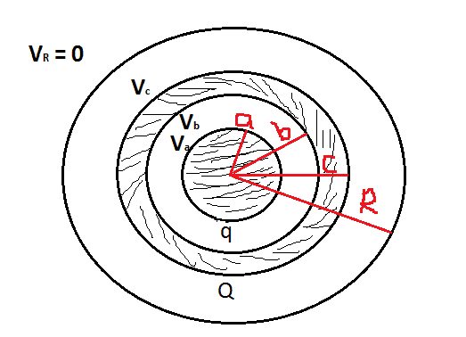

A spherical conductor of radius ##a## carries a charge ##q##. It is situated inside a concentric spherical conducting shell of inner radius ##b## and outer radius ##c##, ##a<b<c##, which carries a charge ##Q##. These two are in turn surrounded by a spherical conductor radius ##R##, which is earthed. Find the potentials at all points in the regions between these conductors.
I thought there might be three different ways I could do this, but it seems for one I get significantly different answers and I would like to know why (also I am not sure if any of my answers are correct). I will use the region ##c<r<R## to show each method.
Method One: Compute the electric field in the region using Gauss' law and then find the potential difference between two points using the path integral ##\phi_{ab}=\int_a^b\vec{E}\cdot\vec{dr}##.
In the region ##c<r<R## the electric field is: ##\vec{E}=\frac{Q+q}{4\pi\varepsilon_0r^2}\hat{r}##. Now the potential difference between a point r (c<r<R) and R is: $$\phi_{rR}=\int_r^R\frac{(Q+q)}{4\pi\varepsilon_0 r'^2}dr'=\frac{(Q+q)}{4\pi\varepsilon_0}\big(\frac{1}{r}-\frac{1}{R}\big)$$.
By some luck this works in that at r=R the potential is 0. But this is only because it is giving the potential difference between the same point. For this reason, and because this gives the potential relative to R, I don't think this is the answer the question seeks. (Consider if the potential at R was set to, say, 5. There are no boundary conditions I have the opportunity to use). Do you agree?

Your method 1 is fine, and is what I would use. There is no problem taking the potential at R to be zero since you are told it is earthed.
I see no evidence that method 3 produces a different answer. You would need to plug in the value of Vc to demonstrate that.

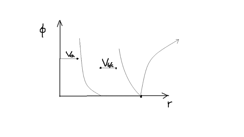

Which would look something like this:
Does this seem acceptable/correct to you? Also just for future reference, is method two also correct? Thanks.
You haven't addressed the region a < r < b at all. When you do, be sure to take into account the fact that the E field is zero for b < r < c. I would stick with method 1 since it's the easiest, but you're wise to pursue alternative methods. Keep at it until you get the same answers for all of them!
EDIT: OK, I didn't see your last post. Looks OK.
I see a couple of problems in your answers.
None of the answers should reference VA etc., they should all be in terms of the charges and the radii.
The potential at infinity should be zero.

This is what I was thinking. Once I drew the graph of my solution for the potential, I thought it was odd that the potential went off to infinity as r went to infinity, but I only thought that because the normal convention is to set ##\phi(\infty)=0##. But in this case it is different is it not? Since we are Defining ##\phi(R)=0##. We can't have both equal to zero, or can we?
This is partially why I wanted to use method two/three, because it seemed more 'surefire' and less room for confusion. I will refer back to my notes when I have the chance, but I think I may have got a more satisfactory answer using method two which wasn't in terms of ##V_A## etc.
I can now say that your method 2 is correct and the preferred way to go. Method 3 is obviously incorrect. I think method 1 may be OK but you haven't done the other region. I would stick to method 2 for both regions which was )and remains) my recommendation in post 12. Can't go wrong with old man Laplace!
Right!
You're doing fine, but let's also see the remaining part of the problem! :smile:

So I had a look at my notes, and by using method two I concluded that:
##\text{ For } r\leq a, ~\phi(r)=\frac{Q+q}{4\pi\varepsilon_0}(\frac{1}{c}-\frac{1}{R})+\frac{q}{4\pi\varepsilon_0}(\frac{1}{a} -\frac{1}{b})##
##\text{ For } a<r<b ,~\phi(r)=\frac{Q+q}{4\pi\varepsilon_0}(\frac{1}{c}-\frac{1}{R})+\frac{q}{4\pi\varepsilon_0}(\frac{1}{r} -\frac{1}{b}) ##
##\text{ For } b\leq r\leq c, ~\phi(r)=\frac{Q+q}{4\pi\varepsilon_0}(\frac{1}{c}-\frac{1}{R})##
##\text{ For } c<r<R, ~\phi(r) =\frac{Q+q}{4\pi\varepsilon_0}(\frac{1}{r}-\frac{1}{R})##
As for ##r\geq R## I'm not entirely how to sure to deal with it. It seems as though you are both saying that the electric field is zero outside the earthed conductor (a 'Faraday cage'), which means the potential must be constant, but how can I get it in terms of the charges held on the other conductors?

Well, the potential is zero at r = R and there is no E field anywhere between infinity and R, so what does that tell you about the potential anywhere r > R?
I'm sorry but I don't know why method three is obviously incorrect. And then you go on to say that you can never go wrong with Laplace, but that was the whole idea of method three. Maybe I am misinterpreting you.
Method 3 is incorrect because you expressed your results in terms of Va Vb Vc etc rather than q and Q.
What I got wrong is the boundary value on the r derivative of Φ(r), which of course is -E(r), at r = R. I assumed the E field at that point was k(q+Q)/R2 but that was wrong. E(r) = 0 for all r >= R. And the proof of that is what I said in my previous post, which is that there is no change in potential in going from r = ∞ to r = R, so the E field must be net zero from r = ∞ to r = R since the electrostatic field is conservative. If you use the correct boundary value of Φ(R) the Laplacian equation solves to the correct value in all 3 nonmetallic regions..
At this point I suggest you stick with haruspex's way but it would be very instructive also to solve the problem with ∇2Φ = 0 as you have already attempted. Just use the correct boundary values for Φ for all three nonmetallic regions. The solution is always Φ(r) = k1/r + k2, k1 and k2 constants. These problems always have the boundary values as traps as I have fallen into!
