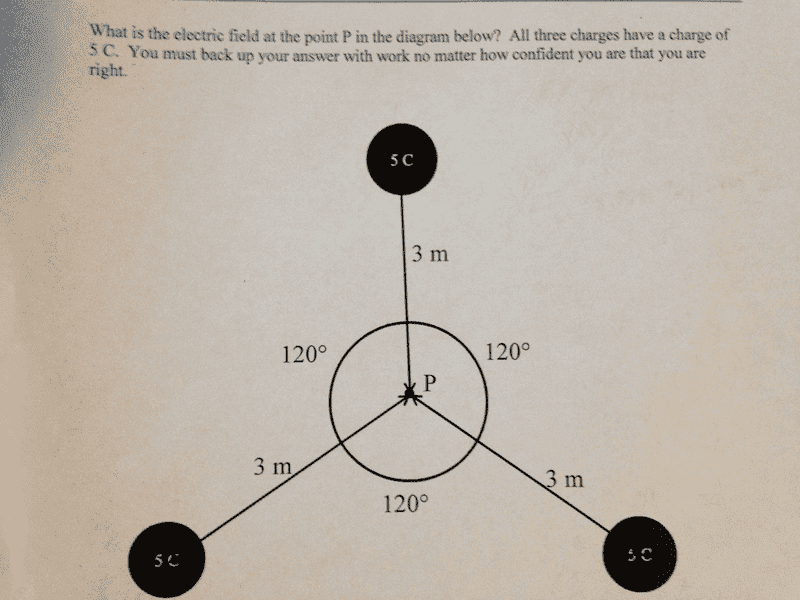

Maybe it is like this with the three strings attached at a common point,
I think we both read it the wrong way? If like above you can figure it out. I thought the strings formed the sides of an equilateral triangle and my mind was locked into that as the only possibility. A Google image search allowed me to see the other possibility.
Good thought. But it doesn't appear that this interpretation would give one of the choices either (unless I'm messing up somewhere).

@Spinnor I am quite sure there was a diagram... but that turn you proposed was quite inspiring. However I think there is a ##\sqrt 2## factor discrepancy with the b/c choices.

If the picture in @Spinnor 's post #7 is correct, then I believe any of the answers (a) through (d) would be correct if the trig function factor is replaced by ##\tan 30^0##.
