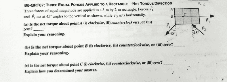

Three equal forces applied to a rectangle, find net torque direction?

Attached below.
T = F.d
This is how I interpreted the problem,
a) The net torque about point A is zero. This is because the forces F1 and F2 are equal and opposite, and they act at the same distance from point A. Therefore, they produce torques that cancel each other out..
The force F3 doesn’t does not produce any torque because it acts along the line of action of F1 and F2 and it passes through the COM.
b) The net torque about point B is counterclockwise because the forces F1 and F2 produce torques that are both CCW, while the force F3 doesn’t produce a torque.
c) The net torque at point c is zero, because it's moment is zero.
I'm not sure with the answers I gave, please point out what mistakes I did. Thank you!

Part (a)
F1 and F2 are not equal and opposite. Their sum is not zero. Also, when calculating torques be sure you multiply the magnitude of the force by the lever arm. What are the lever arms of F1 and F2?
Part (b)
You are correct that F3 produces no torque. Are you sure that F1 and F2 both produce ccw torques about point B? Check again.
Part (c) is correct.

Thank you, for Part a) I know how to find a lever arm for forces but in this case I don't know how to do it. If I take c as the axis of rotation, the line of action for force F1 is crossing the point c in that case it has no moment. Which point should I take, should I take A the axis of rotation?
Yes, for part (a) you need to take point A as the axis of rotation because that is what the problem is asking you to do.

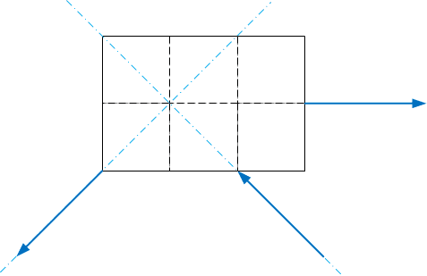

Hi,
Are you aware you can shift a force along its line of action ? If you shift ##F_3## to point ##B## and ##F_1## to ##C##, which of the two has a longer 'arm'?
Likes paulimerci and Lnewqban

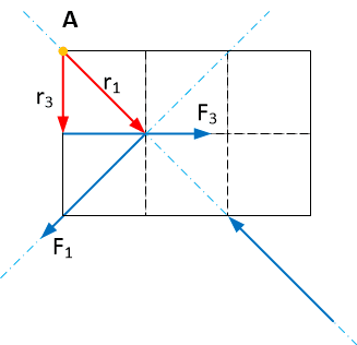

Can't resist... does this help ?
##\qquad##
##\qquad\qquad##
[edit] spot the mistake: top red arrow in B is r2 , not r1

For part A) The moment arm r1 is greater than r3. Therefore, the F1 exerts more torque than the F3. F1 is a CW torque, and F3 is CCW. The answer for part a is CW. Right?
Right.

Even though you don't have numbers, you know that the forces are equal in magnitude. Call that ##F##. As far a distances are concerned, call the side of each square ##L##. Then each torque will be some fraction or multiple of ##FL##. Add the two ##FL##s together and see what you get. Equations provide the most convincing explanations.

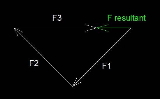

Just a different approach:
I would vectorially add the three forces.
The resultant force should be applied at the common point C.
Imaginarily locating the pivot point at A for a), B for b) and C for c), would allow me to intuitively see how the resultant force would make the rectangle rotate.
Note that there is a non-stable balance for the case that B is the pivot point, eventually causing a rotation (CCW or CW) until reaching a stable balance.
